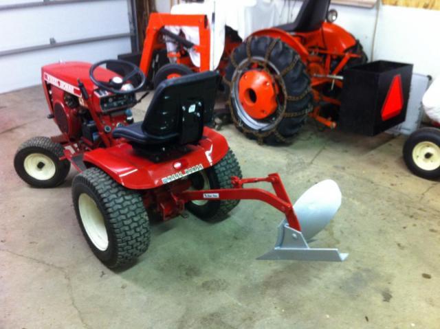

Eric857 54 #1 Posted May 21, 2014 Hello, I am going to attach my earth plow this afternoon and I have never done this before so can someone show me how they have theirs setup so I have something to go off of, the manual I downloaded doesn't help me really so some pcitures and tips from you guys would be much appreciated. Thanks Share this post Link to post Share on other sites

Eric857 54 #5 Posted May 22, 2014 is there a way to do it with a slot hitch? My plow has something on the front that looks to be just like the hook up that is in a dump cart. is this original? How would I hook it up? I'm really lost, if it is not original I have another brinley plow with the correct hookup I can swap onto it. it is seen here http://s769.photobucket.com/user/Eric857/media/WP_20140518_001_zps9e2fe834.jpg.html?sort=3&o=5 this was sold to me as a wheel horse plow, I think i got ripped off. when i looked a while back I thought the wheel horse plows had this kind of curvy frame but I guess i was wrong unless this one is a newer plow.. can you guys help try to identify it too please? if this isnt what I thought it is then Im going to sell it and keep my brinley plow and where is the best place to get front wheel weights Share this post Link to post Share on other sites
squonk 47,900 #6 Posted May 22, 2014 (edited) Keep your Brinly. Sell the pictured plow. I have a Slot hitch to Brinly adapter. PM me if interested Edited May 22, 2014 by squonk Share this post Link to post Share on other sites
shorts 182 #7 Posted May 22, 2014 It looks like someone added a drawbar type hitch attachment to the bottom of the slot hitch bracket that is bolted to the plow frame. Unbolt the drawbar hitch and use the slot hitch setup so you can lift the plow off the ground for transport, adjust the landslide as described above to set the suck or depth of the plow, also their should be a slight twist in the slot hitch adapter so the plow sits flat in the furrow after the first pass and your right side wheels are in the furrow. Share this post Link to post Share on other sites
