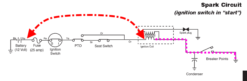

shallowwatersailor 3,220 #1 Posted May 18, 2014 I have been trying to get my 1989 520-H to start since yesterday. It last ran in January when I parked it. I have run through the usual checks and it seems to have settled on the ignition. It cranks and pumps fuel. I have changed plugs, swapped ignition wires with the other 520-H, and changed the fuel filter. I have not checked the condenser. I have placed the inline spark checker between the ignition wire and plug, and I get a spark at the end but not while cranking. I have cleaned a number of terminals including the Molex connector. Now I have just put a lead between the + battery terminal and the + terminal on the coil. The 20 Amp fuse blew! That doesn't come up in any of the scenarios. Any ideas? Also, has anyone ever changed the Molex connector to a Weatherpak connector? Share this post Link to post Share on other sites
Save Old Iron 1,573 #2 Posted May 18, 2014 you absolutely sure you were on the battery (+) and not the (-) ?? you would totally bypass the fuse on the (+) terminal with no way of shorting out the fuse you would short out the 20 amp fuse if you were on the (-) battery terminal . Share this post Link to post Share on other sites

shallowwatersailor 3,220 #4 Posted May 19, 2014 Just duplicated it in case I did make the mistake. I had the same results. Share this post Link to post Share on other sites

Save Old Iron 1,573 #6 Posted May 19, 2014 (edited) Just duplicated it in case I did make the mistake. I had the same results. OK then, here is how I understand this - with a jumper (red dotted below)in place between the + battery terminal and the + ignition coil, the 20 amp fuse blows. The reason I found this unlikely is the fact the current from the battery would go thru the jumper (bypassing the fuse entirely) and head toward the next best ground connection. This next best ground would be the purple pathway thru the coil and then thru the ignition module. The resistance of the ignition module should limit the current thru the jumper to about 3 - 4 amps. Even if the condenser were shorted, the 20 amp fuse would blow when you turned the switch to the RUN position. The diagram doesn't show this properly but on the Onan engine, the condesor is on the POSITIVE coil terminal. Edited May 19, 2014 by Save Old Iron Share this post Link to post Share on other sites
Save Old Iron 1,573 #7 Posted May 19, 2014 The only way I can see a no start condition and blowing the 20 amp fuse with the jumper is outlined in the schematic below The red wire from the battery to the left side of the 20 amp fuse would need to be disconnected from the 20 amp fuse (this would give you no spark) The left side of the fuse somehow is connected to ground (broken wire inthe fuseblock touching ground and fuse no longer connected to the red wire from the battery) This odd condition would allow the best ground to be thru the fuse and not the ignition coil. Applying the jumper would cause current to flow toward the fuse - thru the fuse and then to ground. This would blow the fuse. So if my understanding is correct and you are jumpering the points you mentioned earlier, then this is the scenario I could create to enable the fuse to blow only when the jumper is fitted to the tractor. Check the wiring under the fuse block . Share this post Link to post Share on other sites
shallowwatersailor 3,220 #8 Posted May 20, 2014 So I should check for continuity on the blue to see if it is shorted? Share this post Link to post Share on other sites
