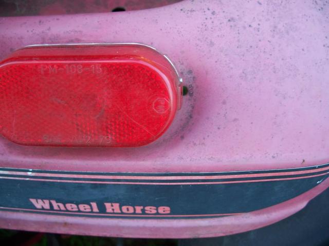

Even on the OEM tail lights you can see the fender hole.  I replaced mine with LED's from  http://www.superbrightleds.com/ and they are the same as the OEMs. To me the holes are not a big deal since the fenders came from the factory like that.
LED on left                                                         OEM on right

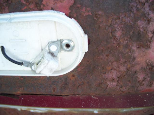

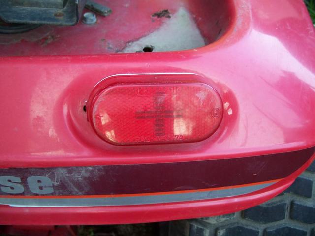

Kelly
My worker 520 with stock tail lights
A junker 312 with stock tail lights
A 520 HC with stock tail lights
I would have to say all the 300, 400 and 500 series have that issue.
