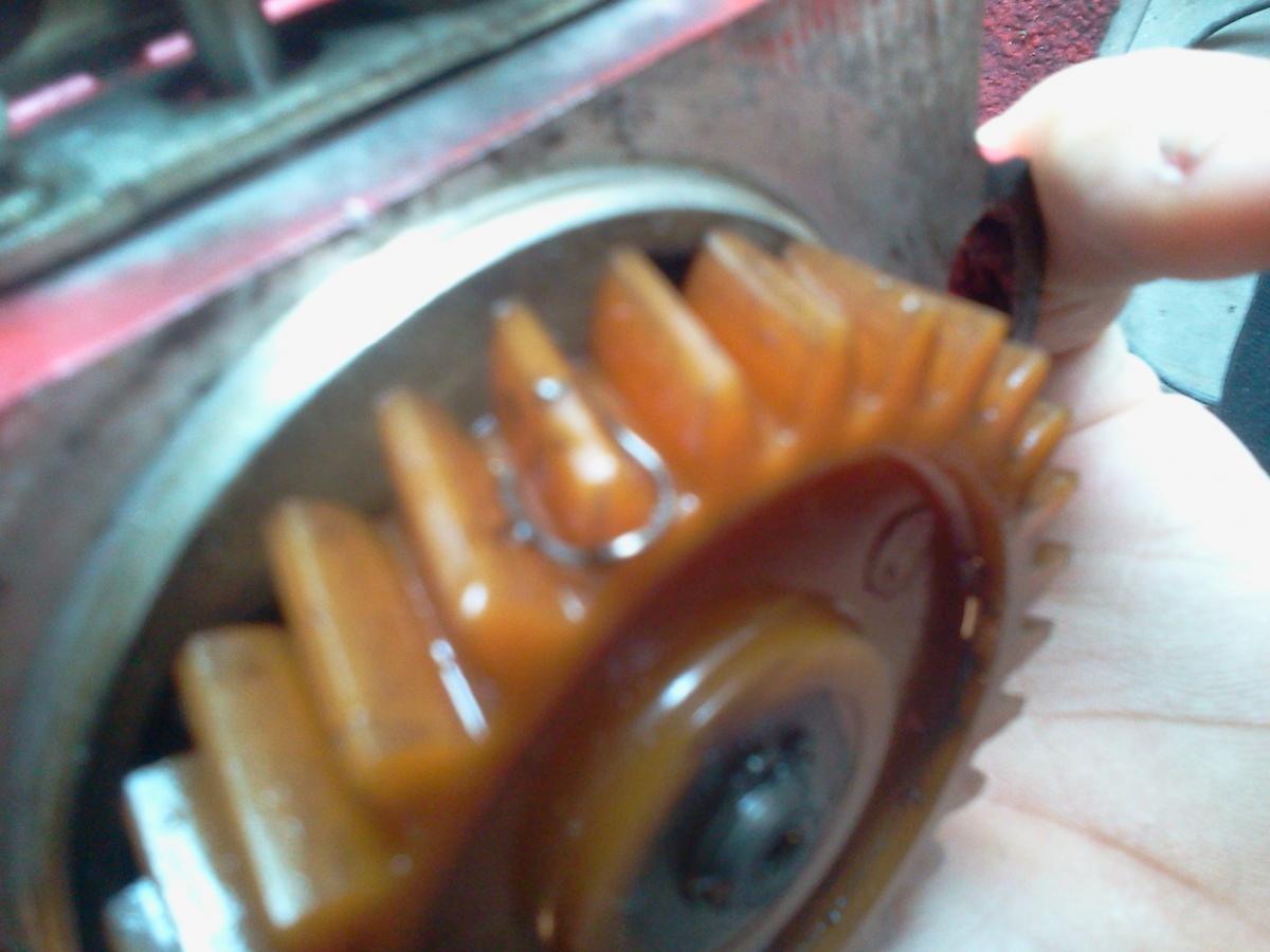

rtfbg 745 #104 Posted November 10, 2014 Working on a bunch of different projects, but it's coming together. Before I start putting things together, I needed to rearrange my garage, and get this beast closer to the door!! I had the old "plane in the basement" thing goin on!! Getting the engine spiffed up, man, there's lots of fasteners to replace on that thing!! I found a little piece of wire on a tooth of the governor drive gear ... not sure if it's supposed to be there or not!! Any ideas??? 1 Share this post Link to post Share on other sites

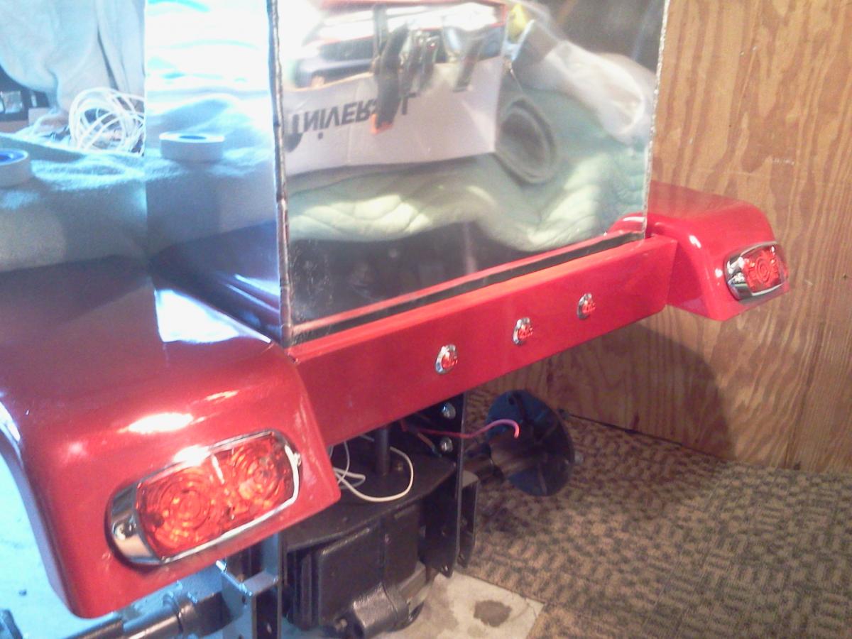

rtfbg 745 #105 Posted November 10, 2014 Hey sports fans ... thought you might like a sexy photo ... how 'bout a little butt shot!! LOL 4 Share this post Link to post Share on other sites

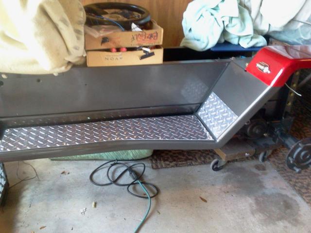

rtfbg 745 #109 Posted November 24, 2014 Well, I finally got my stretched running boards on today, tired of drillin holes!! LOL 1 Share this post Link to post Share on other sites

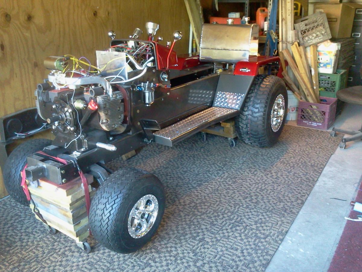

rtfbg 745 #111 Posted November 29, 2014 Well, I got a bit ahead of myself again, but I just had to see SOMETHING that resembled a tractor!! 3 Share this post Link to post Share on other sites
"D"- Man 827 #112 Posted November 29, 2014 (edited) And I thought I was doing a modification on my 18, WOW I might as well quit compared to yours, Bob. That is really looking sweet. If I may ask, did you intentionally reverse mount the front axle? I had thought about doing this on mine but I never tried it to see if it would work. Great progress and thanks for the pictures, Mark. P.S. Where did you get the idea to use a Harley Davidson chrome dual coil cover from? Edited November 30, 2014 by TWIN54 Share this post Link to post Share on other sites
rtfbg 745 #113 Posted November 30, 2014 The jury is still out on the axle flop, I like the looks but the tie rod end clearance appears to be an issue. I'm gonna play with it a bit before I give up and do it right!! lol The coil cover is from a walk-thru of the local Harley shop. They have chrome dog turds there!! Got ma killer horn too, it's mounted on the other side!! 1 Share this post Link to post Share on other sites

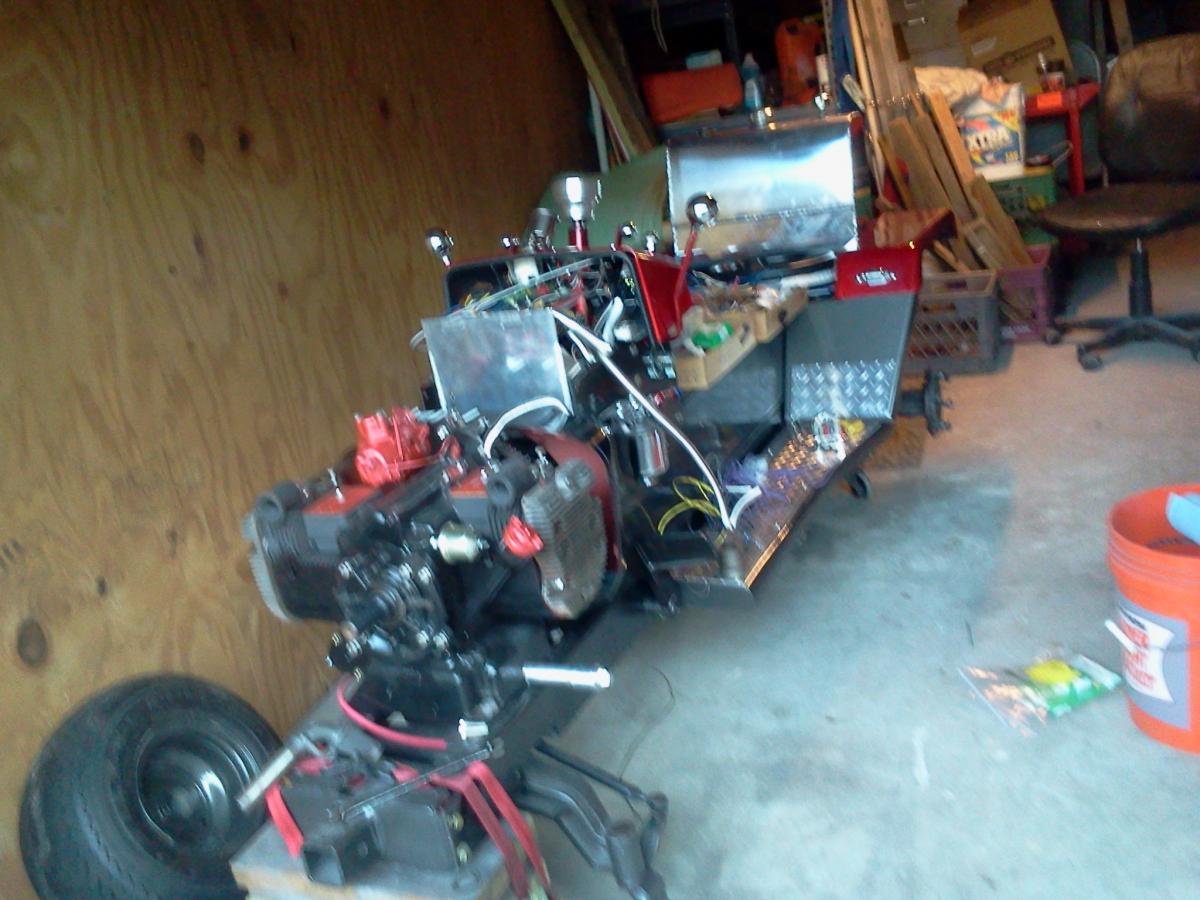

rtfbg 745 #115 Posted December 2, 2014 Hey gang .... need some direction from yunnzz experts!!! Having trouble getting the throttle / governor linkage correct. Seems the spring is in the correct holes, but sure doesn't look like the pic in the Kohler manual. NO I'm NOT sure if this is the correct spring!!! The throttle didn't work, the engine started and ran at one speed, about 3/4 throttle seemed like, so I knew there was some work there. Any chance one of you guys with a variable speed gov can let me know what this SHOULD look like!!! Share this post Link to post Share on other sites
rtfbg 745 #116 Posted December 2, 2014 Oh, Mark ... my welder said NO to bending the spindle tie rod brackets so I had to put the axle the way it was supposed to be. I believed he called me an ASS!! He has NO imagination!!! LOL 1 Share this post Link to post Share on other sites
"D"- Man 827 #117 Posted December 2, 2014 I certainly am no expert, however; for whatever it may be worth, I will point out my observations. 1.) Yes, the spring is in the correct holes. The 4th hole down from the top of the arm & the "2nd" hole down from the top of the speed bracket. 2.) You have the correct 7 coil spring. 3.) Your ball joint from the barrel that screws to the throttle rod should be secured into the next hole down on the speed control bracket. Not sure if this would have much, if any, effect on correcting the 3/4 only throttle problem, {if your top hole mounting set-up currently permits full swing on the speed control bracket.} And finally, since you have removed the variable speed governor from the engine, I must ask did you retime it? P.S. Thanks for the tip on the axle flop! 1 Share this post Link to post Share on other sites
rtfbg 745 #118 Posted December 2, 2014 Mark ... thanks for the critique ... yes, I timed the gov, but have not installed the Point Saver module yet, so the point timing has not been done yet. I observed this issue, lets say there is 2 inches of throttle throw at the dash control. When I pushed it forward, the carb throttle plate was at full open in less than 3/4 of an inch. This made no sense to me, right or wrong. I raised the throttle control rod link spud to the top hole just to see if it gave the throttle plate more of a "slow" action. It seemed to help a bit, with it in the top hole, it doesn't get full open throttle til about half way up the dash control. I see a stop screw on the speed control arm, but there is nothing I can do to get that screw anywhere near the housing where it looks like it would hit. Share this post Link to post Share on other sites

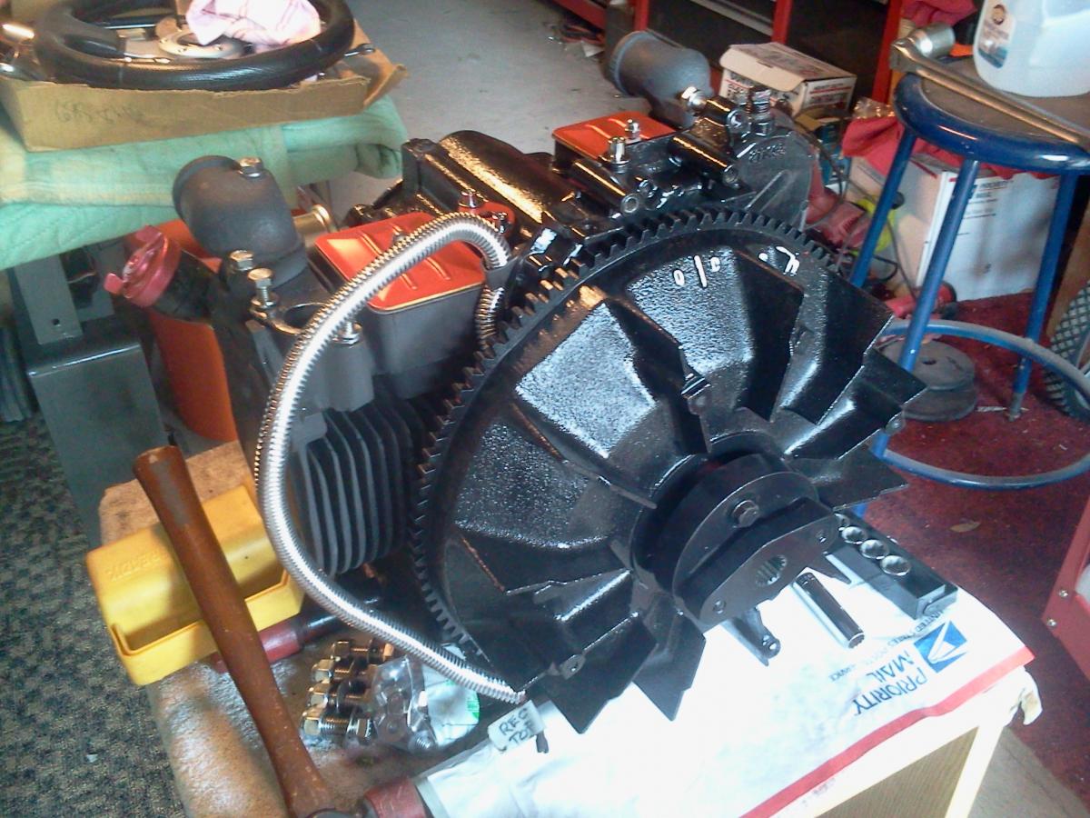

rtfbg 745 #119 Posted December 6, 2014 Ok, so it's like this. If I keep puttin pics on here, when it's finally done, there will not be any WOW factor!!! So ... no more pics!!! I will give you some hints .... this was exhaust week, 100 feet of header wrap, black pipe fittings, adapters, flex pipe, fancy tips, clamps and custom brackets!! Making progress on the choke hookup, needed custom bracket, and still wrestlin' with the throttle linkage, but it's lookin good so far. Stay tuned!! These white pelicans summer in Canada, and come here for the winter. Sure doesn't look like Christmas!! LOL 4 Share this post Link to post Share on other sites

bobert94 38 #124 Posted December 9, 2014 Here's another observation just went and looked at the setup on my 18 auto as previously mentioned everything looks correct with the exception of the control rod spud which you had moved. I did notice that my throttle plates are half open even when throttle lever is at idle. the governor should push butterly closed with engine running,the stop screw on the speed control arm should hit when the the throttle is in the wide open pos its a high speed stop.hope that helps . Great looking job!! Share this post Link to post Share on other sites
