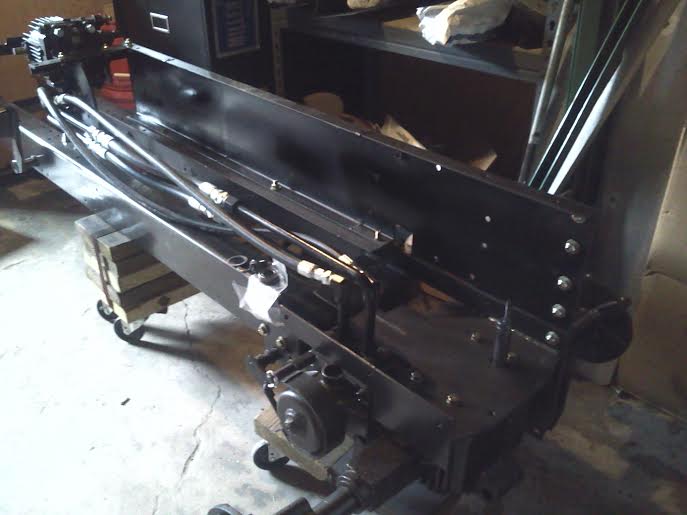

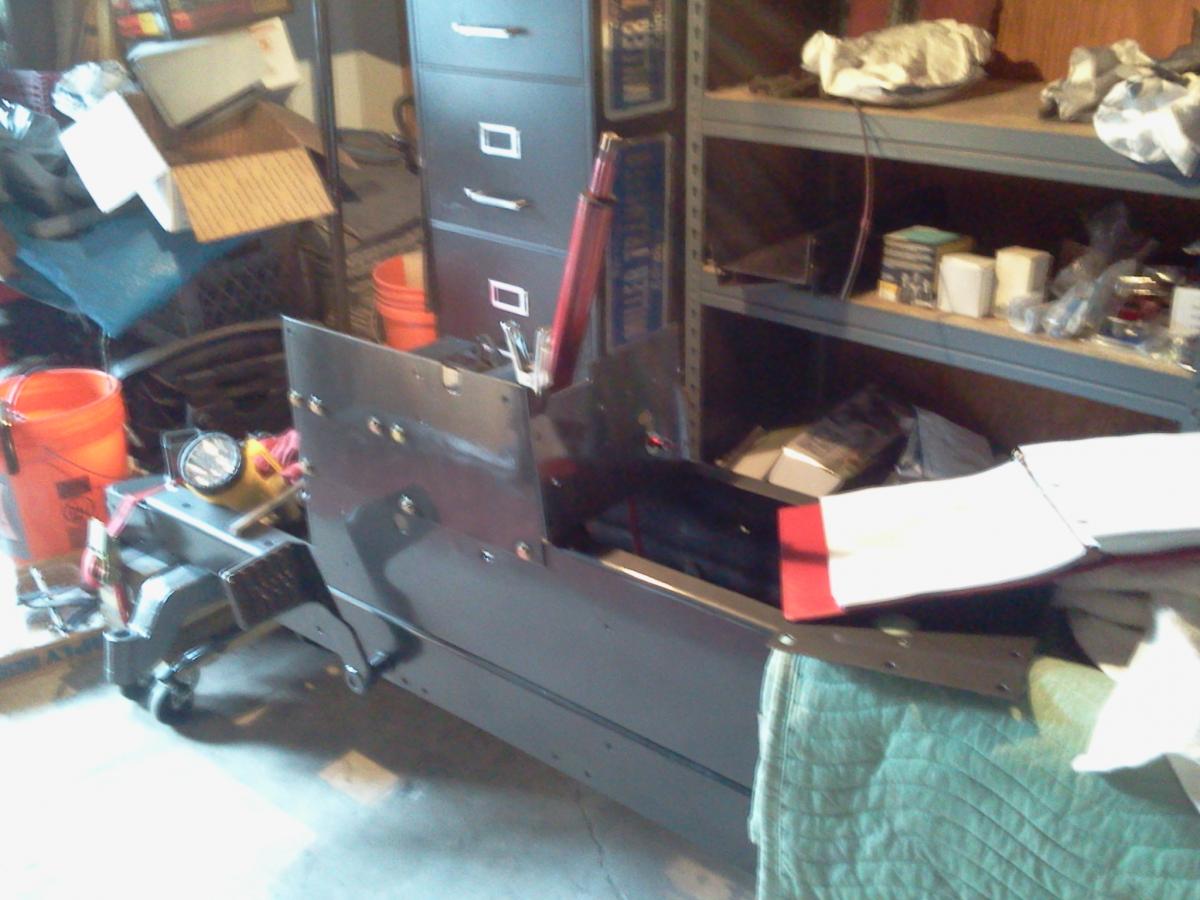

rtfbg 745 #52 Posted July 13, 2014 I know I'm not keeping up to the normal restoration pace I've seen here, but I'm trying. I was working on the steering, but I had a set back. My welder buddy, who is also a triple bypass vet, is in the hospital with some internal problems. So.. find something else to do for a few days. I decided to put one side on. Well, that turned into a project, as I mounted the pump wrong. I put it on top of the frame instead of under it. So unbolt all that, move it, now it's time to drill and mount the side. Thats done, so I think I'll take tomorrow off!! lol 1 Share this post Link to post Share on other sites

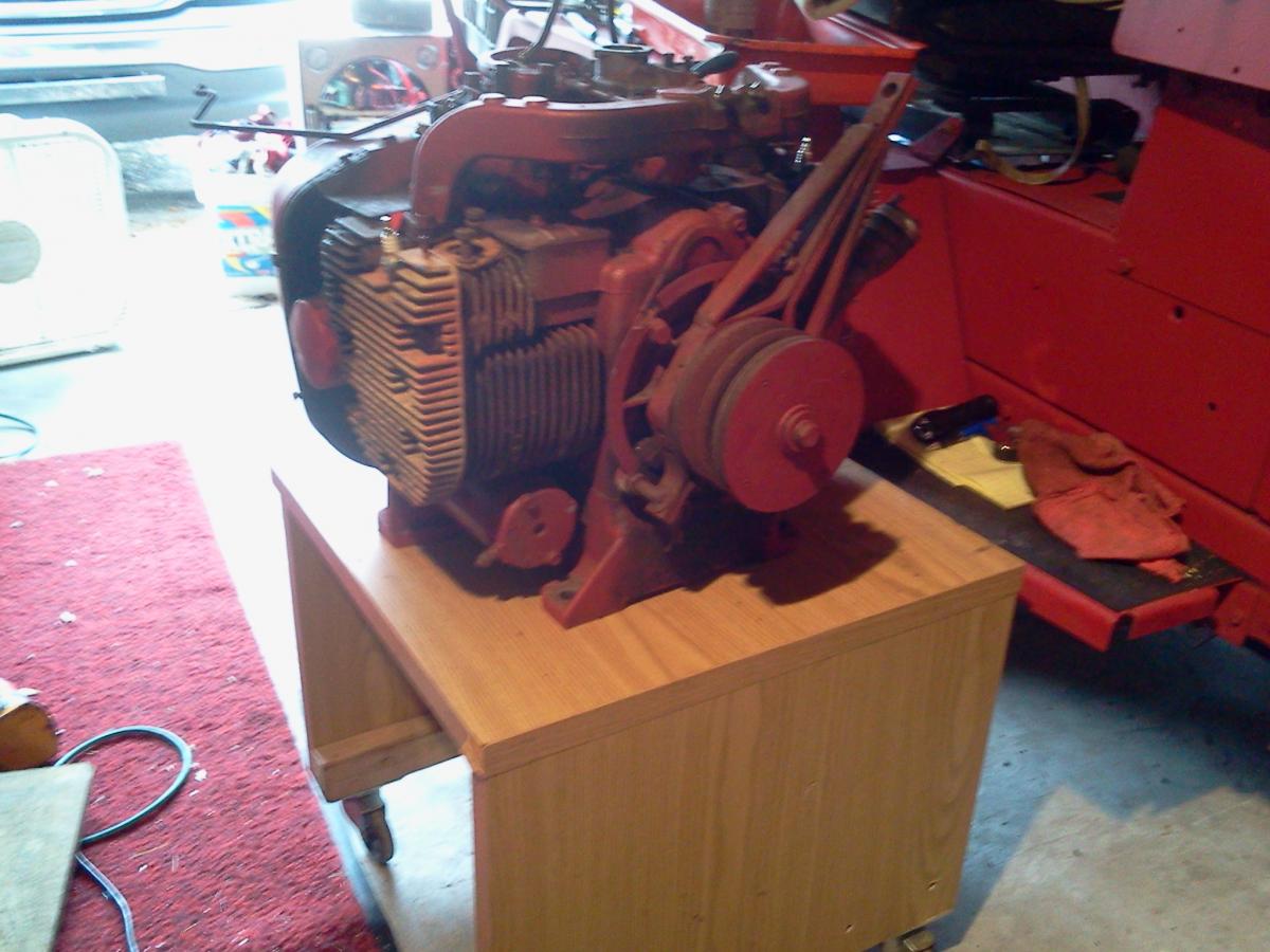

rtfbg 745 #53 Posted July 13, 2014 (edited) Hey ... D guys ... I need some help. My K532 Kohler has ZERO stickers on it. Question 1. .... Is there any other markings anywhere on the engine that will help ID it??? Second, does anyone else have a 1978 vintage K532 that can give me their ID numbers so I can order parts??? I will take a chance that they would be the same. Edited July 13, 2014 by gulftane Share this post Link to post Share on other sites
gwest_ca-(File Mod) 12,283 #54 Posted July 13, 2014 If you are sure it's a K532 here you go Garry Share this post Link to post Share on other sites

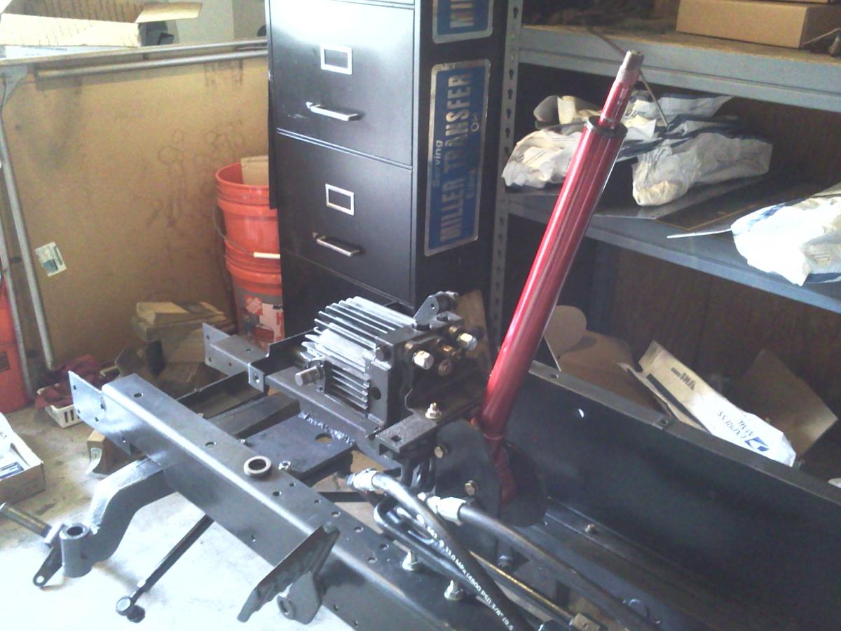

rtfbg 745 #57 Posted July 15, 2014 Well, got the steering box rebuilt, and new shaft put together. Thanks again to BILL PACE for sending me a new spline end for my steering shaft. The custom wheel is a little flatter than the stock wheel, so I needed to extend the shaft a couple inches. Went with a Deere 400 column, shortened it 4 inches, and welded up the new shaft. Will get my floor jack back from my Dad's place to finish the front axle, it's just too heavy to hold and bolt in by myself!! Share this post Link to post Share on other sites

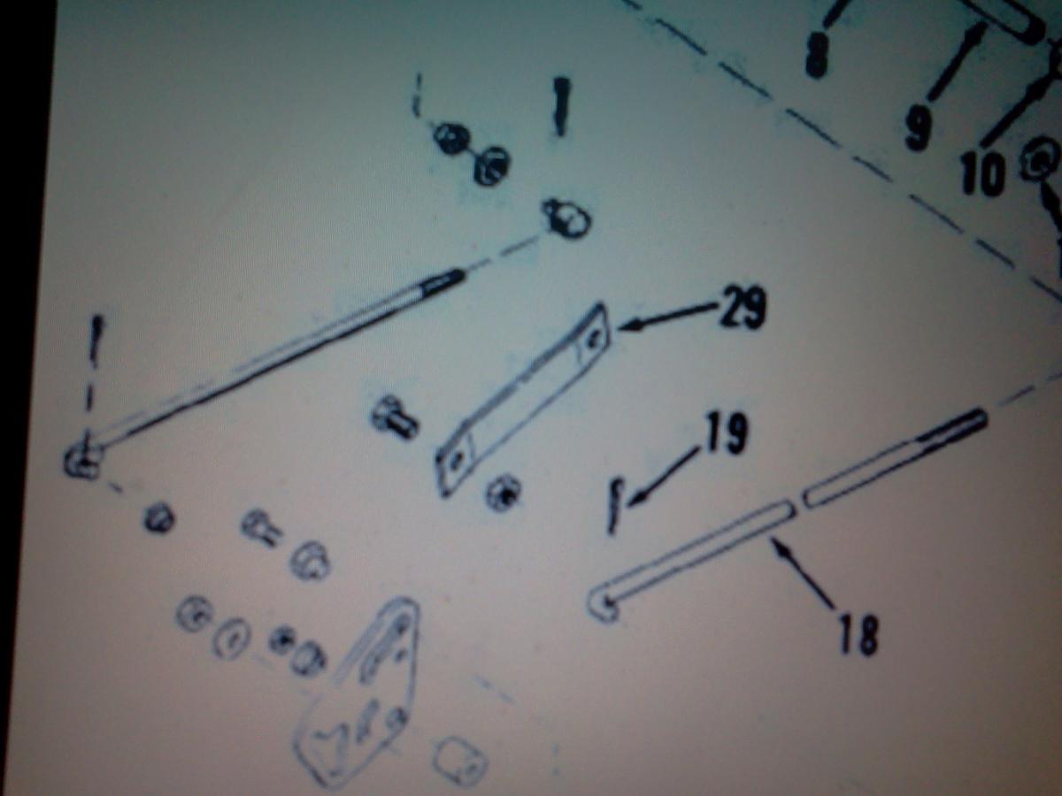

rtfbg 745 #62 Posted August 15, 2014 Well, I'm trying to make some progress on this deal ... but I have run into a snag. There is a "BRACE" that goes somewhere on the control side of the pump. My photos, and the parts diagram don't give me any hints, and I can't remember where it goes!!! HELP!!! LOL ( the brace is about 5 in long and an inch wide, a 3/8 hole in each end.) Share this post Link to post Share on other sites
19richie66 17,893 #63 Posted August 15, 2014 Not sure if mine would be the same but ill look when i get home Share this post Link to post Share on other sites
rtfbg 745 #64 Posted August 15, 2014 Here's the brace, #29 .... no clue!!! LOL Share this post Link to post Share on other sites
19richie66 17,893 #65 Posted August 15, 2014 Apparently mine is different. Mine is a 74 d160 single so maybe they changed it later? Sorry i cant help. Share this post Link to post Share on other sites
rtfbg 745 #66 Posted August 15, 2014 Richie ... thanks for checking!! I should have taken more pics ... I was anxious to get started, and figured I would remember how things went!! RIGHT!! LOL Share this post Link to post Share on other sites
19richie66 17,893 #67 Posted August 16, 2014 https://lookup3.toro.com/classes/doGetPub/?pubid=6980 Here is a setup manual from the toro site.Picture 5-7 is the one you want. d series linkage.bmp 1 Share this post Link to post Share on other sites
rtfbg 745 #68 Posted August 16, 2014 FANTASTIC!!!! Since I don't have the dash ready to install yet, its no wonder I couldn't figure it out!! LOL Thanks a bunch!!! Share this post Link to post Share on other sites

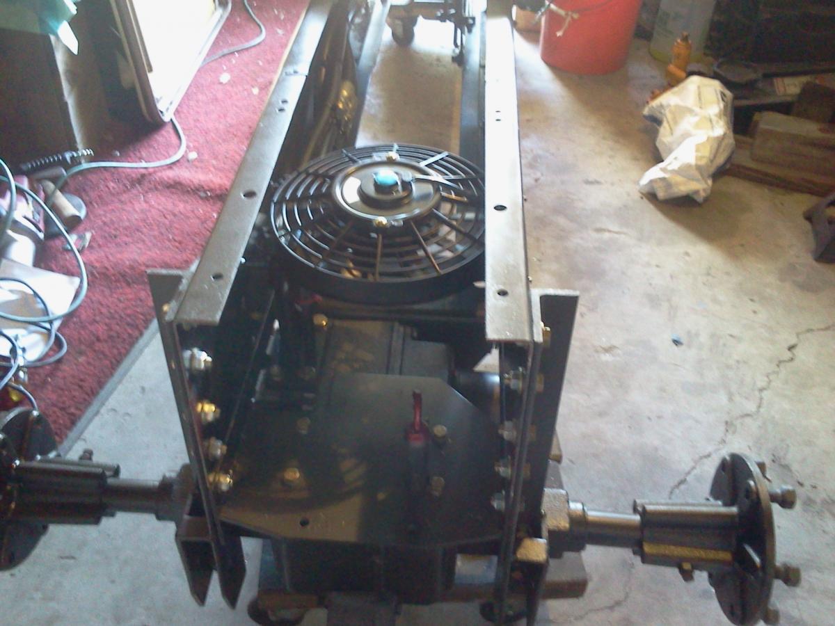

rtfbg 745 #69 Posted August 18, 2014 (edited) I decided to work until it hit 100 deg in the garage today ... wow, a whole hour!! Oh well!! I got a nice 10" electric fan mounted to keep the rear cool, or at least cooler. The extra friction of the soft lines have me nervous, so I figured a little cooling would help. Edited August 18, 2014 by gulftane 1 Share this post Link to post Share on other sites

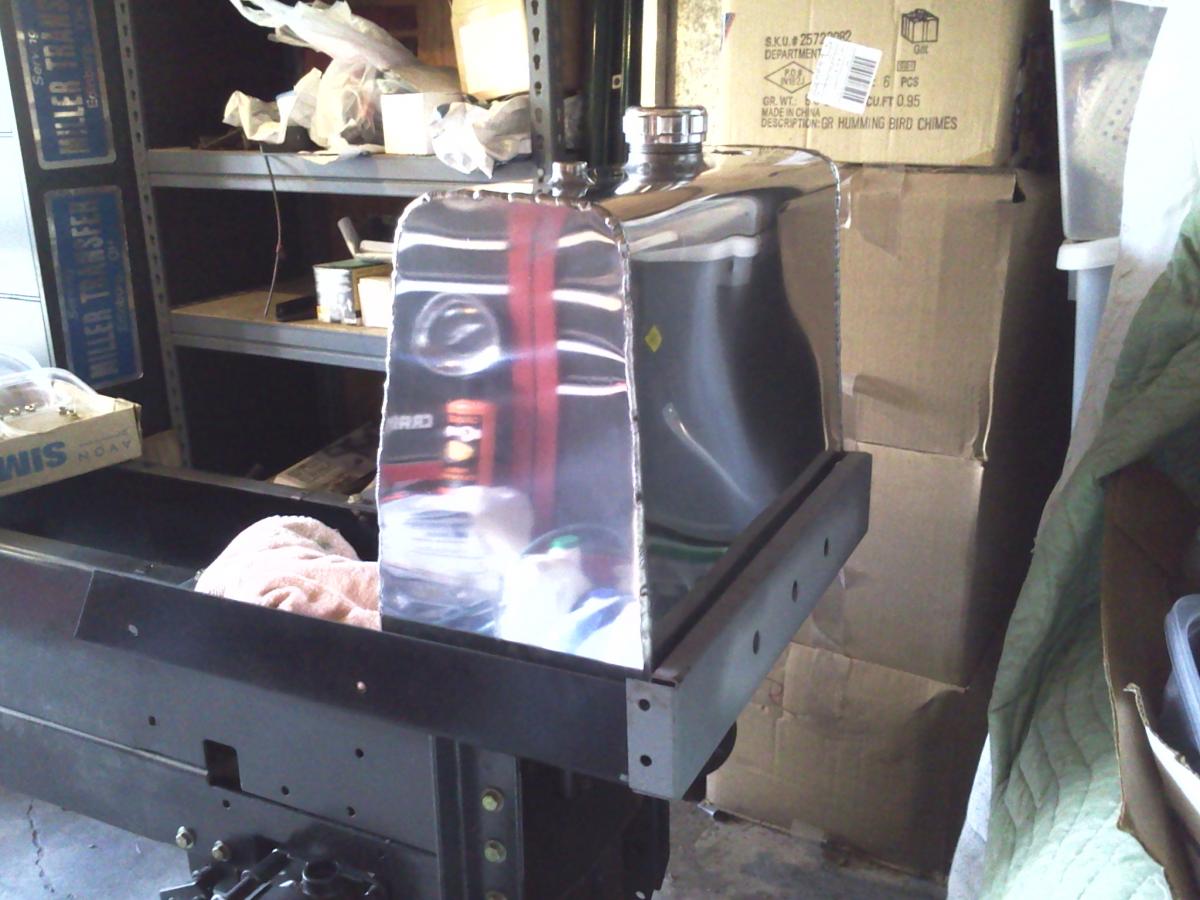

rtfbg 745 #70 Posted August 21, 2014 I know it's way ahead of time, but I got the fuel tank polished, and just had to sit it in place to see what it looks like!! Yippee!! Now, I have to store it for a few months without scratching it!!! 2 Share this post Link to post Share on other sites

"D"- Man 827 #74 Posted September 18, 2014 Here's the brace, #29 .... no clue!!! LOLBob, I have a D-180 so I took some pics of what looks to be an identical or very similar part to the one you have indicated in the diagram. The brace is red in my pics, not the one that appears whitish. Hope this helps, Mark. Share this post Link to post Share on other sites
rtfbg 745 #75 Posted September 18, 2014 Thanks Mark ... that's a great help!! Now, where did I put the dang thing?? LOL Share this post Link to post Share on other sites
