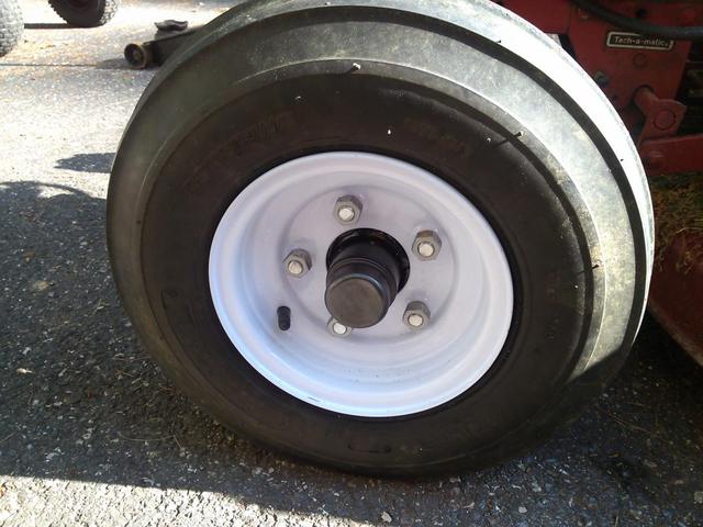

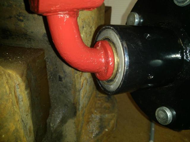

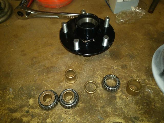

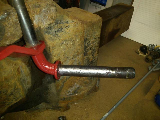

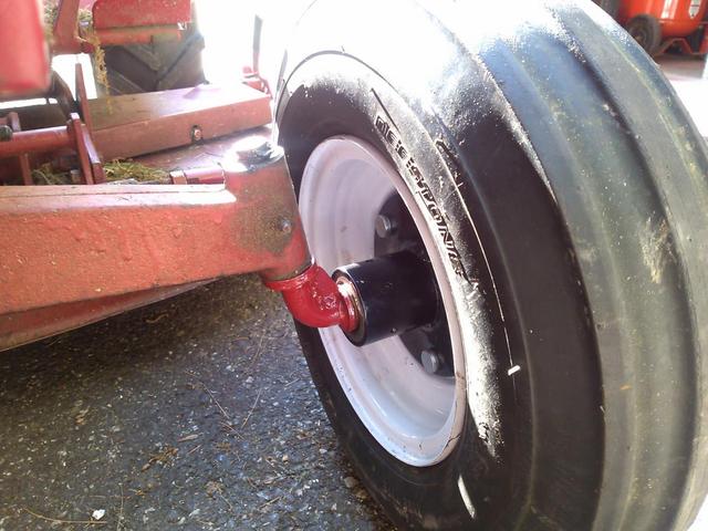

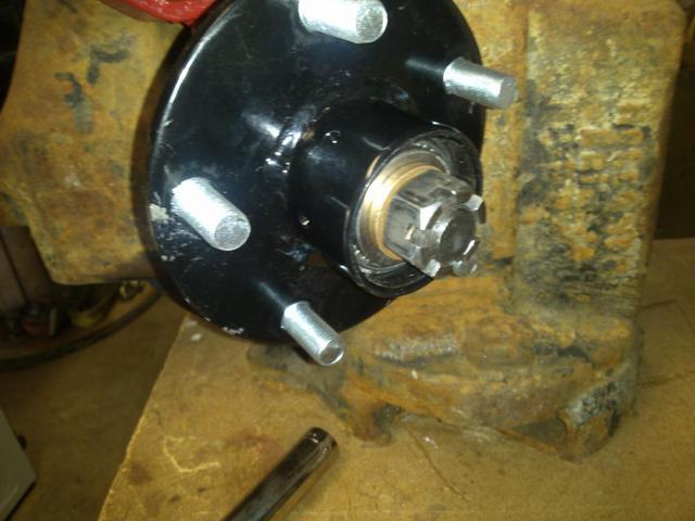

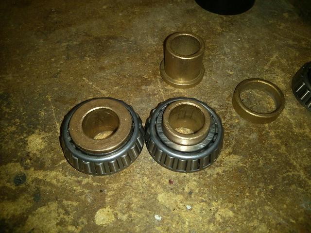

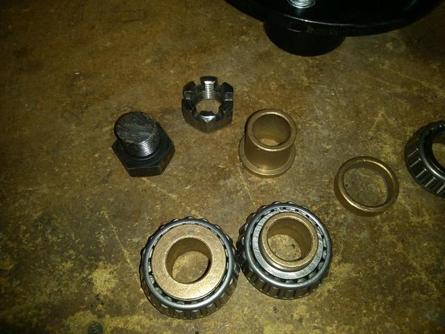

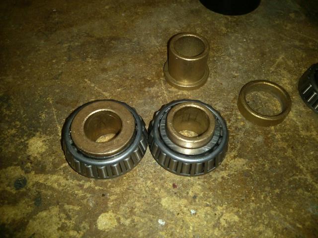

Trouty56 568 #1 Posted May 16, 2014 (edited) I've been wanting to do the wheel hub mod for a while now so I am giving it a try..... Got the hubs at Surplus Center...the 5 bolt low speed hubs for 1" spindles.... Then I got some 3/4 X 1" brass flanged bushings and some 1" X 1 1/4" X 1" brass bushings. Also a couple 3/4 X 2" bolts w/16 thread and a couple castle bolts.... TSC was selling the 3.75 X 8 inch 5 bolt wheels on clearance....got 2 of them.... I think you probably get the idea.....The bushings needed pressed into the bearings....I reversed the inside one to conserve room.....Had I known this I would have just got straight bushings without the flange...I thought I would need the flange to press the bearings together....now I know and can save a bit for the next time...if there is one... The straight bushing was trimmed down for the inner seal to ride on.....it is only about 3/8 inches wide.....all hack sawed and then used the grinder....no lathe in my shop.... Then I cut the spindle down and welded a section of the 3/4 inch bolt on the end...so easy a caveman can do it...well it looks like a caveman did it.... From the outside......still need to drill a hole in the bolt for a cotter pin..... Inside ...seal running on the trimmed bushing...... Total cost...... 2 hubs....33 bucks shipped...Surplus Center bushings, bolts, nuts......25 bucks....Fastenal 2 wheels.....20 bucks Less than 80.... Edited May 17, 2014 by Trouty56 4 Share this post Link to post Share on other sites

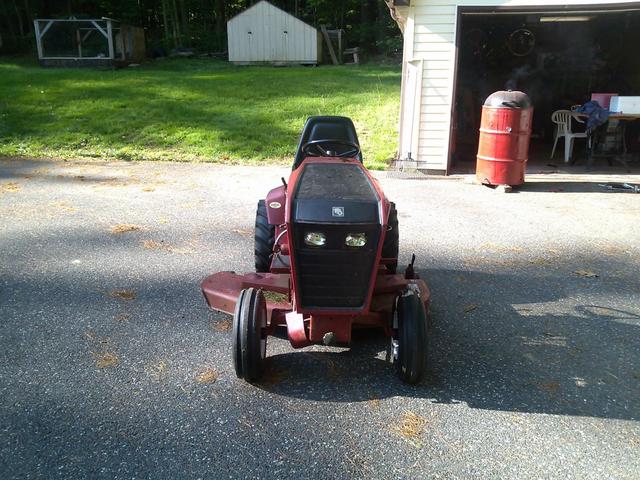

PaulC 342 #7 Posted May 17, 2014 I like what u did but why? What wheels are u wanting to run in the front you left that pic out and I'm kind of curious :-) Share this post Link to post Share on other sites
Trouty56 568 #8 Posted May 17, 2014 I like what u did but why? What wheels are u wanting to run in the front you left that pic out and I'm kind of curious Paul...I like the look of the 4.0/8 tri-rib tires....now I can use rims to fit.... I have tri-ribs on wider rims but don't like the look.... so for 10 bucks a piece I can run narrow 8 inch wheels... Guess I did not take a picture of the wheels.....like these.... Hub set here....http://www.surpluscenter.com/Wheels/Spindles-Wheel-Hubs/5-BOLT-LOW-SPEED-HUB-W-BEARINGS-1-3747.axd Share this post Link to post Share on other sites
Trouty56 568 #9 Posted May 17, 2014 I have to weld a little brace in the arm pit of the spindle yet for a little support because this mod will increase the stance of the front wheels......the rims are centered ...not offset at all.... Might be 2 inches wider... Share this post Link to post Share on other sites

PaulC 342 #11 Posted May 17, 2014 Post some pics when u have the wheels on the tractor id like to see them Share this post Link to post Share on other sites
shallowwatersailor 3,222 #12 Posted May 17, 2014 Bob, Could you have just used a 3/4"-16 die on the spindle, or are they hardened? John Share this post Link to post Share on other sites
Trouty56 568 #13 Posted May 17, 2014 Bob, Could you have just used a 3/4"-16 die on the spindle, or are they hardened? John John....I suppose they could be threaded....they are a bit hard.....but they are not long enough. Came right to the end of the spindle with the circlip ends.... So I ended up cutting them to 3 1/2 inches and adding 1 1/4 inches of thread. Post some pics when u have the wheels on the tractor id like to see them Will do Paul..... Share this post Link to post Share on other sites
shallowwatersailor 3,222 #14 Posted May 17, 2014 I thought that might be the problem with being too short. Thanks! Share this post Link to post Share on other sites

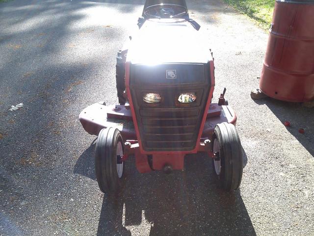

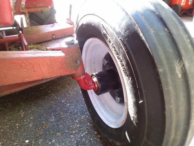

Trouty56 568 #15 Posted May 25, 2014 Post some pics when u have the wheels on the tractor id like to see them Here you go....I cheaped out on the lug nuts...stole them off an old jeep....pretty common size....and a caved the hub cover putting it on.... I was up all night tending the smoker so I finished up the hub conversion.....so what is in the smoker???? Deer roast.....Pork shoulder.....beef brisket (trying for the first time....looks like it will be tasty)..... 2 Share this post Link to post Share on other sites
