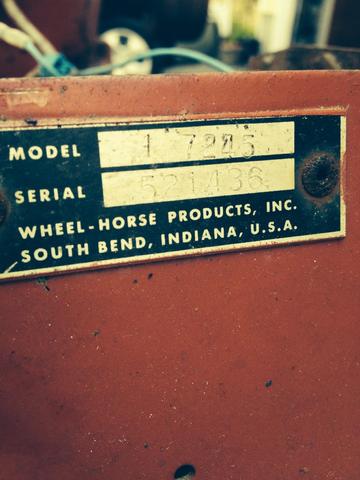

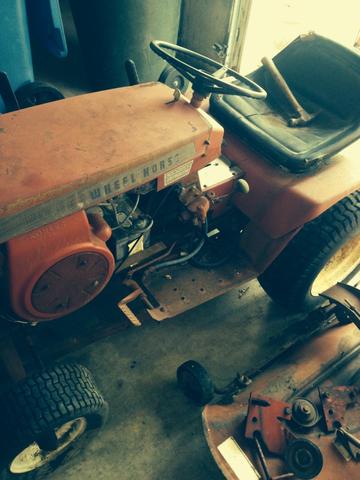

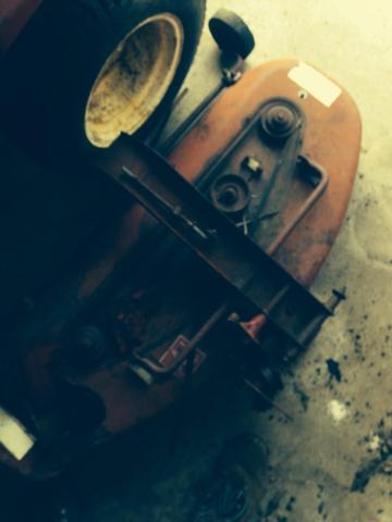

Austin860 82 #1 Posted May 14, 2014 Finally got a horse again, it's a nice Electro 12. I'm not positive, but I'll get re numbers on it tommorow. Sheet metals good, has hydro drive and a hydrolic lift.come with a mower deck and plow. Plow is complete with brackets and so is mower deck. The 12 horse kholer doesn't run, but that next on the list. Already started teardown, I plan to do a full restoration. More pictures to follow 1 Share this post Link to post Share on other sites

Austin860 82 #4 Posted May 14, 2014 First problem, I can't get the steering wheel off. I got the dash housing and the entire steering shaft/Column out, but I can't get the wheel off to remove it through the dash. I tried punching the pin out, and I can't seem to get it out. Thinking I might have to buy a new drill bit and drill it out. Other than that, comming apart easy and it looks good. Excited to get further in the tear down. All my pictures are "too big " Share this post Link to post Share on other sites
pfrederi 20,079 #5 Posted May 14, 2014 (edited) Drilling out the pin is not a good idea. The pin is tough and will probably break your drill bit. Clamp the shaft in your vice and start soaking the pin with Kroil or PB Plaster or ATF/Brake fluid. Get a roll pin punch and after a couple days start whacking on it with a BFH. Edited May 14, 2014 by pfrederi Share this post Link to post Share on other sites
Austin860 82 #6 Posted May 15, 2014 Ok. Thanks for the advice. I already broke one bit....whoops haha. I'll soak with pb blaster tommorow. Keep you updated Share this post Link to post Share on other sites

Irv 115 #11 Posted May 20, 2014 (edited) That model, 1-7245 is a 1969. The Toro site https://lookup3.toro.com/partdex/index.cfm?xCaller=Toro only gives the drawing for the electric clutch and hydraulic system. That has a breakerless ignition so if you have a problem getting spark it may very well be a bad "trigger switch", hard to find and expensive. Be careful with the rewiring because if you cross anyting you can ruin the switch if it's good. Good luck. Edited May 20, 2014 by Irv Share this post Link to post Share on other sites

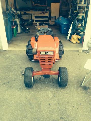

Austin860 82 #15 Posted September 11, 2014 Well she's done. All new paint and decals. Did a conversion from an electric clutch to a Manuel clutch(310-8 donor). Had the deck hooked up and cutting, and wanna hook up the snow blade soon! Thanks for all the help. Into the lawn ranger! Ps the tractor is red, not orange I promise haha 2 Share this post Link to post Share on other sites
