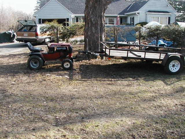

JackC 618 #11 Posted May 11, 2014 Saving the engine would be my first approach or finding a used replacement. There are plenty of mechanics around including home hobbyist types that could do the labor for a lot less. I purchased a 1986 417A that was ugly and did not run for $250. It only had 550 hours on the clock and the clock worked. The PO said there was no spark and a shop told him it was probably a bad stator. After trouble shooting it turned out to be a simple bad connection to the condenser, The carburetor needed to be cleaned and the starter also needed to be replaced due to many attempts by the PO to start the engine. The baby runs like a top and other than some rust there is very little wear. It also came with a great 48 inch side discharge deck and chrome hub caps. These deals do come up from time to time. Here she is doing some yard duty for me. 2 Share this post Link to post Share on other sites
