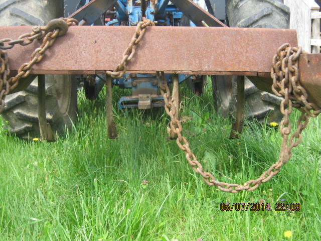

swarfeater 49 #5 Posted May 8, 2014 only weight is water in the tires, no ags just chains. low range, first gear, full throttle, tiller all the way down. just hold on the brake when you first lower the tiller or she will jump. good job but wont go very deep, so after I till full depth I use my homemade subsoiler set at 12" deep on the big tractor on 6" centers then another pass with the tiller. easy work !!!! Share this post Link to post Share on other sites
