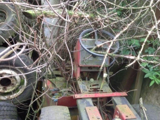

diggerjames 64 #1 Posted May 7, 2014 Hi all as you may of followed my previous post about finding a C 175 in a yard , I've decided I want to do something Different as you know my business revolves around plant machinery so I'm going to put this horse on Tracks . Which I'm sure I'm going to have a lot of head scratching to do , any advice gladly welcomed , thanks James The donor tractor Share this post Link to post Share on other sites

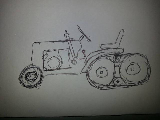

Eric857 54 #2 Posted May 7, 2014 I have always thought about putting two transaxles together on the back of an existing tractor and having tracks made to go over the wheels for more ground contact... 1 Share this post Link to post Share on other sites
C-101plowerpower 1,606 #3 Posted May 7, 2014 this already sounds like an awesome project james, what are you thinking of? half track or full tracks back to front? Koen Share this post Link to post Share on other sites
diggerjames 64 #4 Posted May 7, 2014 (edited) Hi Koenig , Eric I'm think of full tracks , home made etc . I was thinking of using mini digger tracks but I like the idea of making my own . I've seen a couple of very good ideas on you tube,which has given me some inspiration to do it . That's a good idea too Eric ! Edited May 7, 2014 by diggerjames Share this post Link to post Share on other sites
redrooster 83 #5 Posted May 7, 2014 I've never seen a half-track horse. That would be interesting! Maybe something like this? 1 1 Share this post Link to post Share on other sites
Eric857 54 #6 Posted May 7, 2014 yes sir, that would be the way i was thinking of, and if you engineered it right you could have four wheel drive in the back. you could really push some snow with that bad boy Share this post Link to post Share on other sites
diggerjames 64 #7 Posted May 7, 2014 That looks a good idea be ok for logging etc with a winch on the rear ! Share this post Link to post Share on other sites
bmsgaffer 2,065 #8 Posted May 7, 2014 If you do half track, the transmission should work as is, I would just put turning brakes on for added traction control. If you do full tracks, I would go all out with a full on hydraulic pump and hydraulic drive motor on each track. Seems like adapting the transmissions are more time and effort than just to buy hydraulic hub motors. There should be some good surplus of these things around. Steel tracks will be sweet, but rubber tracks and 15+mph would be sweeter... 30HP EFI Kohler engine or 3 cyl diesel... Share this post Link to post Share on other sites
diggerjames 64 #9 Posted May 7, 2014 That's a good idea Brandon but I want to use as much wheel horse parts as possible including the transmission but anything can change ! James Share this post Link to post Share on other sites

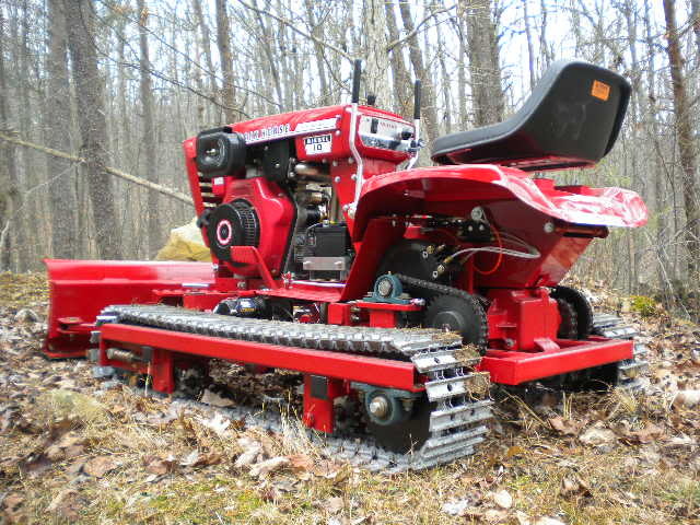

ol550 838 #18 Posted May 12, 2014 There are a lot of good ideas on Massey's mini dozer thread. 1 Share this post Link to post Share on other sites
rexman72 210 #19 Posted May 12, 2014 that looks like a beast of a machine Share this post Link to post Share on other sites
Kwa1ski 1 #20 Posted May 14, 2014 That dozer is sweet! *Goes to check out thread* Share this post Link to post Share on other sites
AMC RULES 37,250 #21 Posted May 14, 2014 (edited) Another one of my all time favorites... here's Massey's dozer thread. Edited May 14, 2014 by AMC RULES Share this post Link to post Share on other sites
