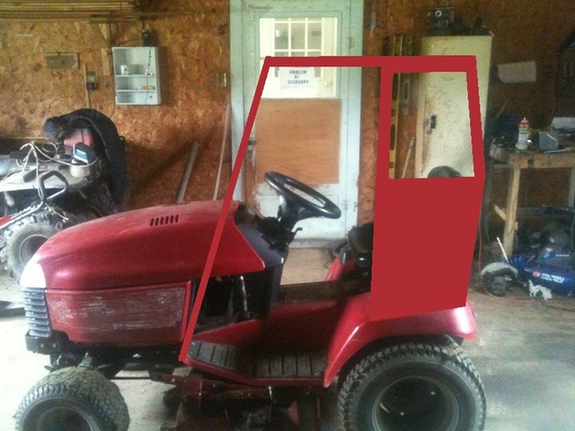

Camdg2010 8 #45 Posted May 17, 2014 anyone know where to find a snow cab for it? i would like to build my own custom cab but i want it more or less permenent because where i mow it blows all over me and it gets in my eyes and mouth and in winter im gonna need it for the snow anyways... heres a pic of what im thinking... maybe a little taller BUT NOT TO TALL because the snow cab looks goofy Share this post Link to post Share on other sites

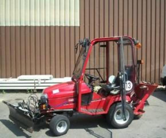

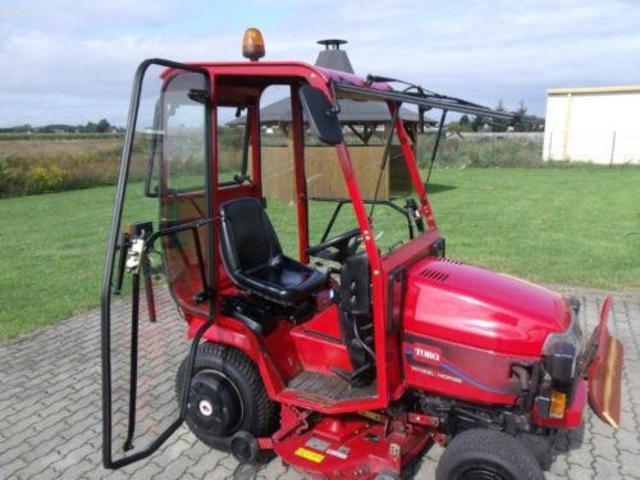

Rick_in_CT 156 #46 Posted May 17, 2014 Good to hear that your got our steering system fixed. The snow cab in the pictures that I posted earlier was the factory supplied cab, and it was made by The Original Tractor Cab Company (originalcab.com). They still list a part number for the 5xi tractor on their web site. You might get some ideas for a custom build by looking at the photos of their cabs on the web site. I only use the cab during the winter, and with the blower you really need it. I don't think it would last too long if I used it year round, as I think the sun would have a negative effect on the vinyl, and it would get brittle pretty quick. I think with some thought, you could build a year round cab. My cab is currently sitting upside down fully assembled in the garage, let me know if you want some photos of the interior frame work. I also have quite a few pictures of the framework attached to the tractor, that I can provide. Another site that you might want to get some ideas from is Curtis Cab (curtisindustries.net). They make hard sided cabs for compact tractors. These are more of the year round type of cab. For use cutting grass, you would want to have some good ventilation, as it could get pretty steamy in there during the hot summer months. During the winter, the cab never warms up from the engine, so I don't think that there is much heat transfer coming back into the cab. Noise inside the cab is also a consideration. I always wear hearing protection when using the tractor. Keep us posted. Share this post Link to post Share on other sites
shallowwatersailor 3,221 #47 Posted May 17, 2014 anyone know where to find a snow cab for it? i would like to build my own custom cab but i want it more or less permenent because where i mow it blows all over me and it gets in my eyes and mouth and in winter im gonna need it for the snow anyways... heres a pic of what im thinking... maybe a little taller BUT NOT TO TALL because the snow cab looks goofy I would suggest that you make the door the full side. That way you can access the gas fill without needing to work around it. Try "Googling" Toro 5xi cab and you should find some European tractors with cabs. Share this post Link to post Share on other sites

RMCIII 840 #50 Posted August 23, 2015 Depending on what you decide to do for the cab, a suggestion would be, to have (2) sets of doors. (1) that would be used for summer with a "mesh" type lining, the other (1) for winter with the "vinyl" or some other material.RMC 2 Share this post Link to post Share on other sites
