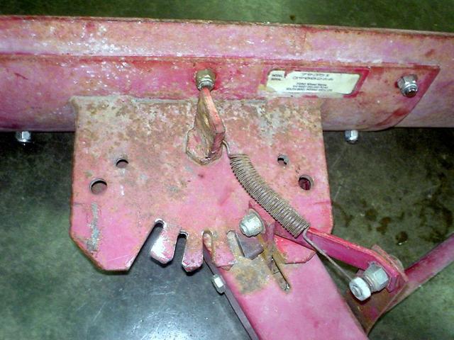

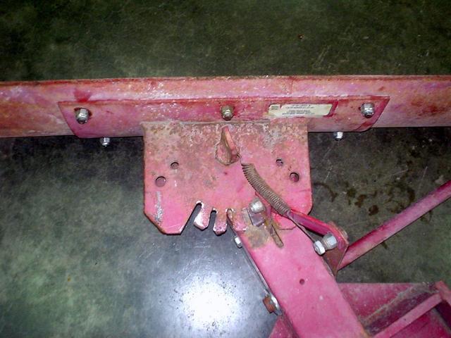

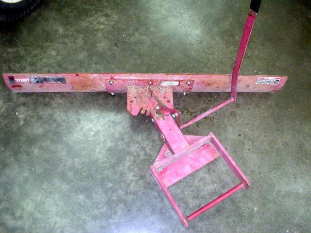

cleat 7,686 #1 Posted May 4, 2014 Cut 2 more slots in the frame to allow for 5 positions. This should allow for more options in grading abilities. Cleat Share this post Link to post Share on other sites
rexman72 210 #2 Posted May 4, 2014 very cool I hear those grader blades rock Share this post Link to post Share on other sites
tbarnhart 240 #3 Posted May 5, 2014 Will it clear the rear tire? Share this post Link to post Share on other sites
cleat 7,686 #4 Posted May 5, 2014 I did not add more angle, just a mid position. I plan on doing that to the snow blade as well by drilling 2 more holes. Cleat Share this post Link to post Share on other sites
pfrederi 19,007 #5 Posted May 5, 2014 I did not add more angle, just a mid position. I plan on doing that to the snow blade as well by drilling 2 more holes. Cleat Be interested to know how the snow plow modification works for you. I looked at the 3 hole version and there didn't seem to be much room for an additional hole. In the 5 hole version the last two holes seem to be further out..the blade angles bit more 1 Share this post Link to post Share on other sites
Tankman 3,523 #6 Posted May 7, 2014 I added additional positions to my snow blade, easy enough and works well. Share this post Link to post Share on other sites
