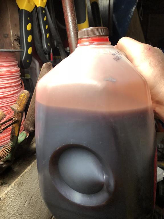

Firsttimer 22 #24 Posted October 31, 2018 (edited) Pulled the tow value out today along with seat,fenders and rear tires. Tomorrow I will drain the oil and filter and inspect to see what they looks like ,will snap some pictures tomorrow. It always seems like there’s never enough hours in the day ! HOpen you all have a good day tomorrow ! finally had time to drain the tranny, it was a brownish red and only got about 3/4 of a gallon out of it (see photo) I replaced it with new trans fluid and a new wix filter and the axles turned but the hydraulic cylinder Still doesn’t work. I will do a pressure test as soon as time allows. thanks for the help and any advice would be welcome ! Edited October 31, 2018 by Firsttimer 1 Share this post Link to post Share on other sites
