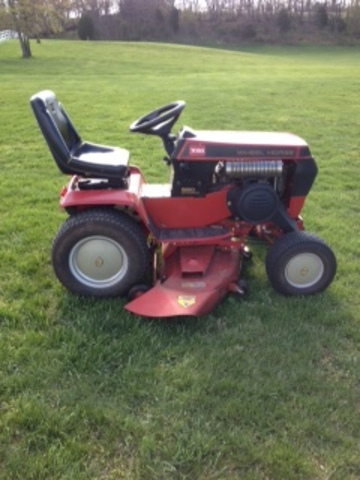

ztman 0 #1 Posted April 28, 2014 Hi, I am new to the forum and just picked up a 1996 520 H . This is my first Wheelhorse. I noticed the ground speed seems to be slow. Are there any adjustments to speed up the mower? Model number is 73502, serial number 6900910 thanks Share this post Link to post Share on other sites
gwest_ca-(File Mod) 11,931 #2 Posted April 29, 2014 Operator manual but don't think it covers your problem Have often heard of grass clippings and dirt getting stuck in the shift linkage restricting it's travel. Manual on the hydro Garry Share this post Link to post Share on other sites
ztman 0 #3 Posted April 29, 2014 Thanks, I will check it out. My motion control lever is on the steering column, not between you legs like in some of the diagrams in the manual. I will take a look under the sheet metal to see if anything is restricting travel. Share this post Link to post Share on other sites
cheesegrader 434 #4 Posted May 8, 2014 ztman, The lever is on the column, but most of the linkage is under the black cover plate between your legs. It can clog. I had a similar problem with my '96 520. The cam that adjusts forward/reverse speed is under the seat. Mine had what felt like creosote all over it. Cleaned it off, blocked up the rear end, and made the adjustments acording to the hydro manual so that the rear wheels come to a complete stop in neutral, and it has been fine ever since. Share this post Link to post Share on other sites
ztman 0 #5 Posted May 8, 2014 Thanks, I will try the adjustment. Saw the linkage under the seat, but didnt have an opportunity to track down the specific instructions in the hydro manual. Share this post Link to post Share on other sites
