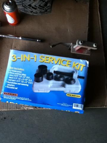

Terry M-(Moderator) 2,329 #14 Posted April 27, 2014 This is what I used. Bought it from HF. Got the idea from another member and it worked nice. I can't even remember what this tools real purpose is. All I did was Just soaked the pin good and let sit over night, put my impact wrench on this tool and let it do the work, Took maybe five minutes to push it out . 2 Share this post Link to post Share on other sites
chazm 413 #15 Posted April 27, 2014 TerryM ,its a ball joint remover...good idea Share this post Link to post Share on other sites
