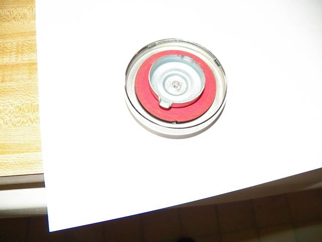

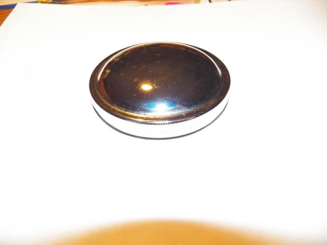

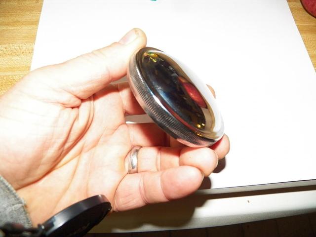

buckrancher 2,697 #6 Posted October 5, 2014 modified john deere radiator cap exact copy of original Brian 1 Share this post Link to post Share on other sites
buckrancher 2,697 #7 Posted October 5, 2014 hard to get a good picture with the glare from the chrome but here it is you need to drill two small holes for a vent one in the center and one just at the edge of the red tank seal gasket if you have a original look at the bottom of it and copy Brian Share this post Link to post Share on other sites
