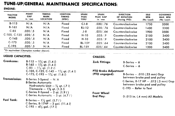

stratostar250 934 #1 Posted April 16, 2014 Hey All! Since I've obtained my 82' C-105, I have been tinkering with it here and there, and I feel that it was about time to try and sort out the running speed and the idle. I have tinkered with the throttle cable and adjustments, according to the book/Kohler repair manual, and I just cannot grasp how to do exactly what I want. I have a visual tachometer which seems to work well. I was able to get the engine speed up to about 3350-3400 rpm (which I find acceptable compared to the 2900 it would only rev up to) But now, I have no idea how to bring the idle lower. The idle is around 2700-2600 rpm and I would very much like to lower it (It went much lower before i brought up the running speed, sometimes to where it would stall, but I made some adjustments to the idle fuel screw on the carb, I feel that was out of adjustment, it idled much better after and I had forgotten to take an rpm measurement). I am just hoping someone can maybe give me some pointers on how to do this. I appreciate the help because I cannot figure it out! Oh, and the random question is, the Wheel Horse owners manual from 1982 says that the idle rpm for this tractor should be 2100 rpm. I am just curious as to why this may be, and if I should try to set it there, or if this motor is safe to idle lower (I'm sure there is a reason why it was claimed to idle so high though). It is a model K241AS. I am mainly wondering, because the K241S on my 310-8, the idle speed in the Wheel Horse owners manual is 1000 rpm . I am just surprised at the difference. I appreciate all your input guys! Share this post Link to post Share on other sites

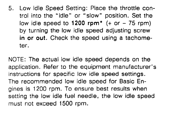

rmaynard 17,563 #5 Posted April 17, 2014 I'm not sure why the 1982 C-105 has an idle speed of 2100 RPM. If you check the Kohler service manual, it states that idle speed should be at 1200 RPM +/- 75. Then it goes on to say that the idle speed should not exceed 1500 RPM. Here is a snapshot from the K-Series manual. Share this post Link to post Share on other sites
stratostar250 934 #6 Posted April 17, 2014 (edited) I'm not sure why the 1982 C-105 has an idle speed of 2100 RPM. If you check the Kohler service manual, it states that idle speed should be at 1200 RPM +/- 75. Then it goes on to say that the idle speed should not exceed 1500 RPM. Here is a snapshot from the K-Series manual. idlespeed.png Yeah, I was surprised, I saw that too, and thats why I was asking, unless it is a typo in the wheel horse owners manual, but it does say 2100 Edited April 17, 2014 by stratostar250 Share this post Link to post Share on other sites

rmaynard 17,563 #8 Posted April 17, 2014 Sure seems easy enough to transpose the 1 and the 2 when preparing the manual. 1200 suddenly becomes 2100 and the proof-reader missed it. If it were mine, I would go by what the Kohler manual says, not the owners manual. 1 Share this post Link to post Share on other sites
stratostar250 934 #9 Posted April 19, 2014 Sure seems easy enough to transpose the 1 and the 2 when preparing the manual. 1200 suddenly becomes 2100 and the proof-reader missed it. If it were mine, I would go by what the Kohler manual says, not the owners manual. I agree, I think that is what I am going to do. Share this post Link to post Share on other sites
