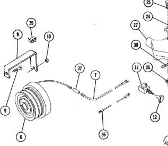

I put an electric clutch on my C-175 without any issues.  The end of the crankshaft should have a tapped hole in it.  Bolt in that holds the clutch on.  There is one bracket that bolts to the engine bearing plate. I am looking for a service manual covering electric PTO.
If your crank has no hole SB#126 tells how to drill and tap the crank.
Manuals are on page 6 of the wheelhorse manuals in the manual section here

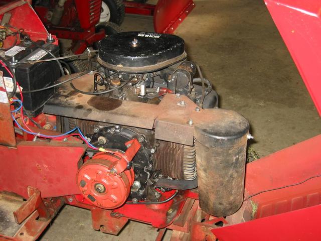

Went out and looked at 2 electric PTO I have.  There are two different designs.  On one version the keyway comes all the way out front of the PTO It is threaded (interrupted by the keyway) for a 1" bolt.  The other design the keyway ends where the crankshaftt would end and the hole is treaded for 5/8"/11 uninterrupted thread.  In both instances these threads are not for holding the PTO on they are use to push it off the Crankshaft...you do not use a puller on the electric PTO.  I can take pics if you need them.

daveoman1966
Here are the two styles of Electric PTO.
Well Paul according to your description and Daves pic I have the post 1973 style...actually I have 3 of them...lol.... And coincidently the post 1973 version is installed on my 1971 Charger 12 and its definitely been on there since Moses was a baby..... probably since new. I guess once the rain showers here cease I will commence to getting the old manual PTO bell off...however that happens
