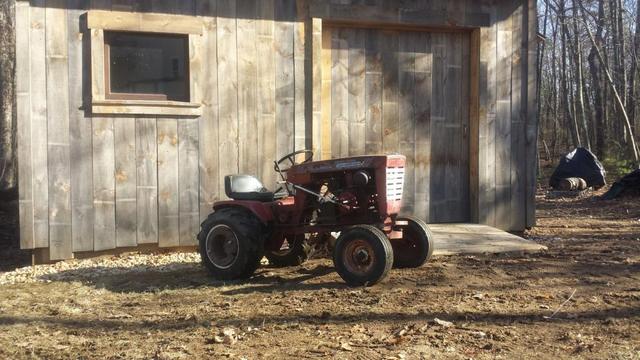

Nathanielperz 150 #1 Posted April 8, 2014 Hey guys i need help with what kind of oil i need for my k 301. I know you need different oil for different climates and its been in the 40-50 range lately. (but in New England the weather can change from 55f to 20f in a day) Anyway with the weather getting warmer i need to know what kind of oil i need. The poor tractor hasnt had an oil change in over 15 years! Thanks in advance, Nate Share this post Link to post Share on other sites
