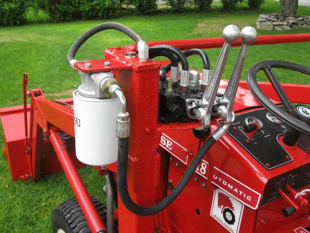

stevebo-(Moderator) 8,590 #9 Posted April 8, 2014 I agree that it sounds like a blockage. Do you have an in line filter? If not I would highly recommend you install one. They are pretty easy to install. You can get one from TSC or other. I would check all the lines and make sure that they are not the issue but you can only tell when you are putting pressure on the system. I would then drain the entire system, install the filter and re fill. You may want to try and flush the system as well with something that will flush like something light. I do not know what you can use but someone here may chime in to tell you how to flush the system. Maybe diesel?? Here is the filter I installed on my ark a few years back. Share this post Link to post Share on other sites
Hodge71 690 #10 Posted April 8, 2014 I agree that it sounds like a blockage. Do you have an in line filter? If not I would highly recommend you install one. They are pretty easy to install. You can get one from TSC or other. I would check all the lines and make sure that they are not the issue but you can only tell when you are putting pressure on the system. I would then drain the entire system, install the filter and re fill. You may want to try and flush the system as well with something that will flush like something light. I do not know what you can use but someone here may chime in to tell you how to flush the system. Maybe diesel?? Here is the filter I installed on my ark a few years back. I think the diesel idea would be fine Steve as you're not going to be really lifting anything with it, just using its for its cleaning properties. Not sure I would be lift the arms or bucket as you will then fill the cylinders with diesel as well but I guess if you lower and curl you will then empty the cylinders as well.....oh and Steve...I just drooled all over my Macbook looking that that picture of your 18....maybe a bit jealous.... Share this post Link to post Share on other sites
