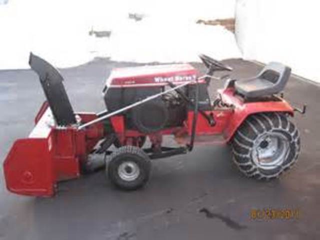

matthon 11 #1 Posted April 7, 2014 OK, I have a few ideas to run by the professionals. I have a 314-8, and my brain was wondering a few things. Why is the plow attached to the rear? If I hit something unexpected, even with the plow springs, I immediately think the axle is going to snap. Also, it makes an already heavy attachment heavier due to the position of the lift in the middle. Why not attach the plow to the front? The JohnnyBucket is attached this way, and I have seen older Ber-Vac snowblowers attached the same, pic below. By attaching it to the front, doesn't that allow for a greater lift? ATV plow lifts- I see a Warn with actuators, has anyone put one of these on a WH? Also, there is also a kit to turn a plow into a bucket, it seems reasonable, and I am sure we have all thought of it- has anyone used one of these on a WH plow? I know some buy a cheap winch and mount that on the front, and that appears to work well. Was there ever a WH plow, factory of aftermarket, that attached to any of the attach-matic locations in the front? When I look at all of these, it appears that the JohnnyBucket is a beefed up version of the bracket and lift arm that attaches a snowblower. Could the WH snowblower pieces be used to attach a plow? I am a little lost at the moment, as I have a broken tendon from snowplowing, and due to other circumstances little time to be creative. Finding a hydro is not easy, and most are quite expensive. I use this plow all year long, for everything and anything, plus it is somehow stress relieving pushing snow and dirt around, but there is no way I can lift this thing up and down over and over and over. Any input is appreciated. Share this post Link to post Share on other sites
