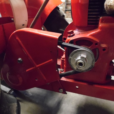

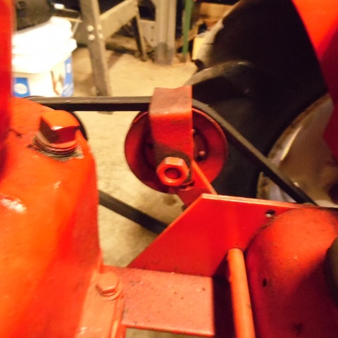

Molon_Labe 731 #127 Posted September 24, 2014 Not much to add right now. Other things have kept me too busy. I did get the tool box and seat spring installed as well as the front end parts painted. I'll post pics when I get a little more done. This came in the mail today. Purchased direct rather than Ebay which saved a little. He has both styles for Suburbans as well as RJ's. Also RJ 25/35 pulleys and reverse disks. I'm real happy with the guard. I don't know if I'll have to do any mods to it so I'll wait to paint it until I get to that point. Bob I don't know where you picked up the belt guard but I too need one as some PO cut the front of the guard off mine just behind the drive pulley. Very nice. Share this post Link to post Share on other sites
Racinbob 12,996 #128 Posted September 24, 2014 Yes, I think it's very nice. I believe the 61's had the raised rib in a cross pattern and the one I got is for a 60. He does both as well as the other items i mentioned. Joe has asked that I don't post his contact information but privately is fine. PM incoming. Share this post Link to post Share on other sites
Molon_Labe 731 #129 Posted September 24, 2014 Yes, I think it's very nice. I believe the 61's had the raised rib in a cross pattern and the one I got is for a 60. He does both as well as the other items i mentioned. Joe has asked that I don't post his contact information but privately is fine. PM incoming. Thanks Bro Share this post Link to post Share on other sites

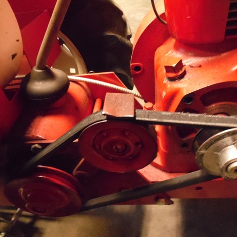

Molon_Labe 731 #130 Posted September 24, 2014 Bob here is a pic of my belt guard along with a couple of the clutch finger, Share this post Link to post Share on other sites
Racinbob 12,996 #131 Posted September 24, 2014 (edited) Thanks M. I was thinking along that line. A bunch of the models used that to stop the belts. Are you sure that's original? I thought Suburbans used a round rod. Not that it matters because I think your style setup will do a better job. Edited September 24, 2014 by Racinbob Share this post Link to post Share on other sites
Molon_Labe 731 #132 Posted September 24, 2014 Bob I can't tell what 's original and what isn't after who knows how many PO's, but it does work. Share this post Link to post Share on other sites
Racinbob 12,996 #133 Posted September 24, 2014 I hear that. If it's not original it's probably a better design and certainly something that's easy to make. 1 Share this post Link to post Share on other sites

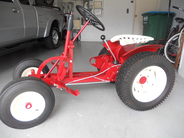

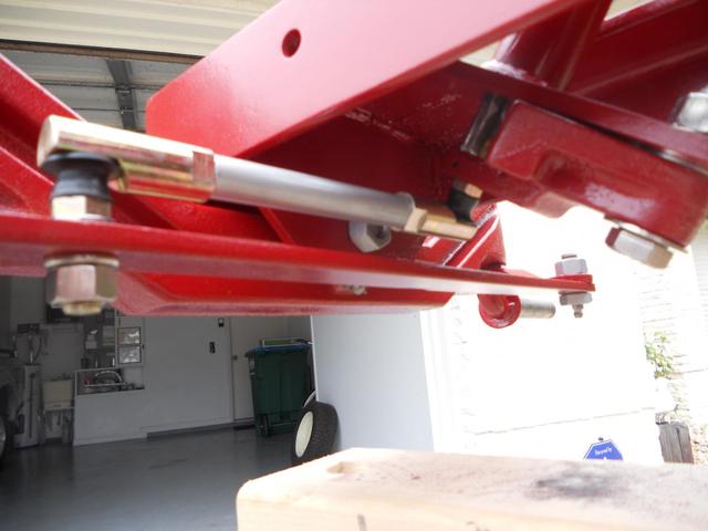

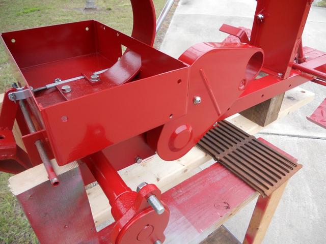

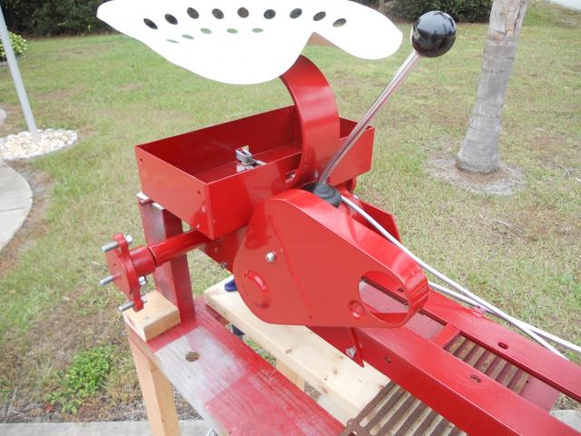

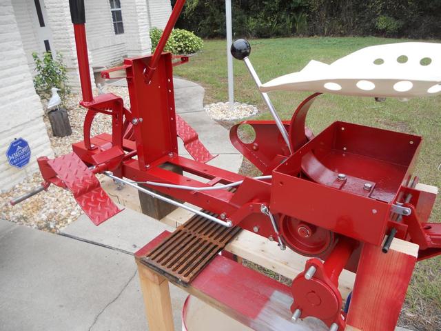

Racinbob 12,996 #134 Posted November 14, 2014 A fairly major project on this house and one at a rental has limited me to a few minutes here and there on my Suburban. I was going to wait until the fenders were done to take more pictures but a paint issue set me back and I wanted to post again. After three attempts to save the fenders I’m now going to strip them down again and start over. I did get the front end put together and I’m happy with it. It works great and there’s no play. I was anxious to see the repop belt guard in place. One of the head bolts on a Tecky motor I tore apart worked as a standoff for it after some minor modification. I don’t think the tractors immune system will reject it. The seat is painted with Krylon Ivory and I think like the color. It’s a tad darker than the picture looks. I’m not sure if the rear hitch lift cable is the proper length. I’m wondering if it will run under the engine properly. The wheels were covered with tranny oil and I thought all they would take is some sanding and a repaint but after cleaning them up the current paint job is as bad as the rest of the tractor was so it will be a complete strip. They have tubes but this one went flat. I’ll remove the tires to redo the wheels and install new tubes. 5 Share this post Link to post Share on other sites

Racinbob 12,996 #138 Posted November 14, 2014 Thanks guys. I know it's been slow going but I'm having a blast. Even having to start over on the fenders didn't really bother me. M, I don't know if I'm the one to be taking notes from but I sure will be looking forward to seeing your rebuild in progress. Obviously mine isn't a restore to factory original but that's just one of the fun things. Everybody can do it their way. Share this post Link to post Share on other sites

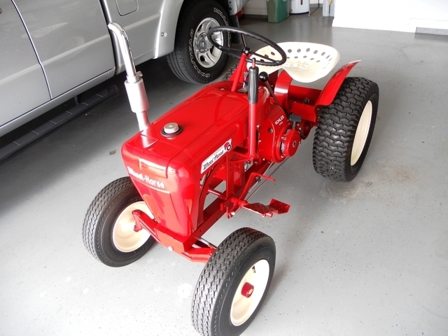

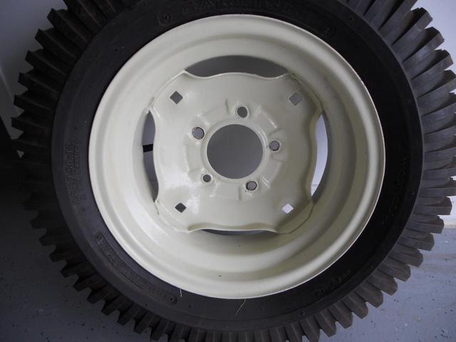

Racinbob 12,996 #139 Posted September 28, 2015 I pretty much quit working on it this summer. It's just too hot and humid. Last winter I had far too many other projects going to spend much time on the 400. Besides working out there I was having gloss paint dry dull. The wheels gave me fits. All I can think of is the heat and humidity was messing with the paint. We had a couple better days and I was finally able to finish them and get her back on all fours. The hood shouldn't take a whole lot more body work. The motor runs fine but the PO put a tapered crankshaft in it and welded the pulley. I'll be grinding that off and installing the right crankshaft. I'll go ahead and rebuild the carb while I have it apart and I'll also tap the exhaust port. This WILL get finished this winter and then it's on to a 500 Special. 4 Share this post Link to post Share on other sites

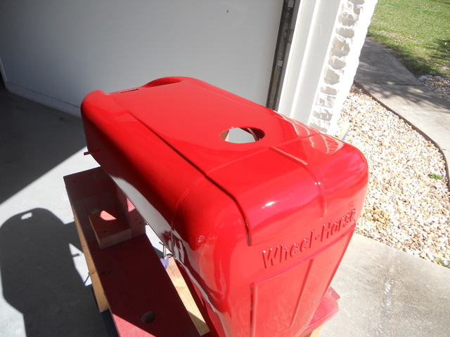

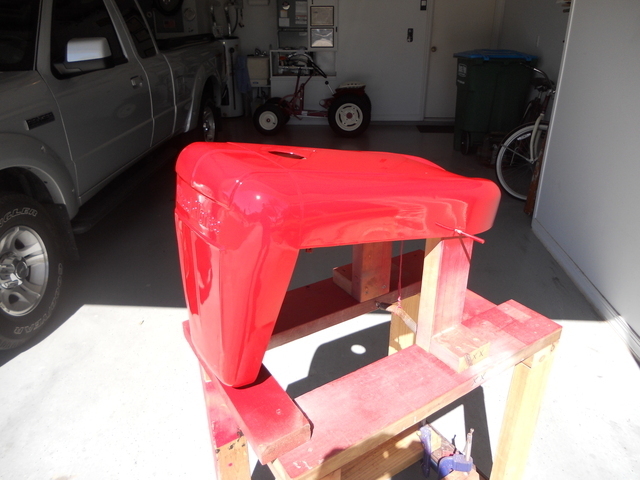

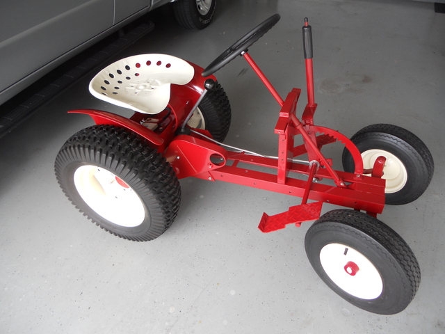

Racinbob 12,996 #147 Posted February 13, 2016 (edited) I got a bit more involved playing with a couple of tractors that were given to me and not staying with this one. I got the crankshaft replaced in the K91 and the tins painted. As I've said many times, I'm not a body man and I really struggle with it. I wanted to put one more coat on the hood but the weather wasn't cooperating until yesterday. Sunny, 70's, low humidity and light winds. Just as I was rushing to get it in the screen room after spraying it one little green bug landed on it. It's barely stuck by his feet and I think I'll be able to buff it out. You can see him in the pictures if you know where he is. Zoom in and he'll say 'Hi'. The hood straps are way thicker than normal so I extended the gas tank filler neck. I enlarged the hood hole and will put in a gasket like what the Lawn Rangers used.....I think. Some drying time, paint the letters, decals, finish the motor and I'll be set for a picture to send Terry for the big show banner. Edited February 13, 2016 by Racinbob 5 Share this post Link to post Share on other sites

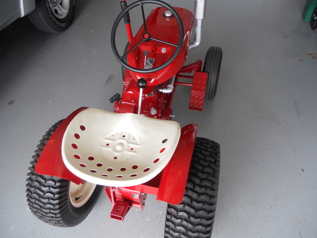

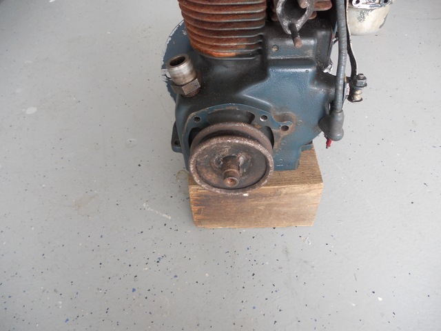

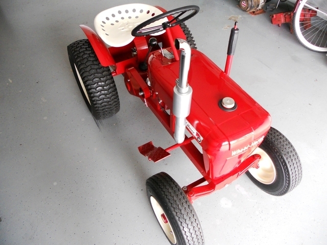

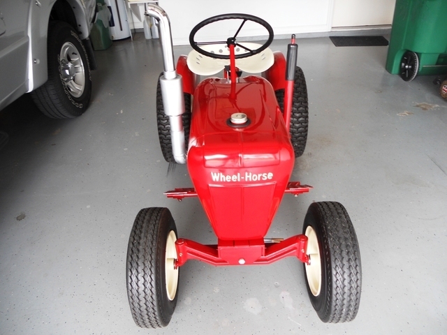

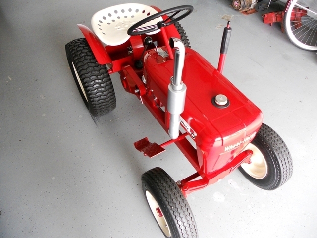

Racinbob 12,996 #149 Posted March 8, 2016 With this project going so slow I usually search the title of this thread to bring it back up. The search hasn't worked well. I just discovered why. Look at the typo in the title. SuRburban Can one of the men in blue fix that? Anyways, here she is. Among many small changes from original is the kill button on the dash. It was the one on the motor when I got it. If you remember the PO spun the rod and installed a different crankshaft with a tapered shaft and welded a pulley on the taper. That had to go. He gave me the original crank so I had it turned .010 and reinstalled it with a new rod. The exhaust port wasn't tapped so I tapped it 1/2" NPT, ran a nipple in then a 1/2" to 3/4" street elbow. There's s few little things to do such as a fuel line, exhaust heat shield, a flanged bushing for the steering column a new starter rope handle and I'm sure I'll find other things. Next up, the 500 Special. 12 1 Share this post Link to post Share on other sites
