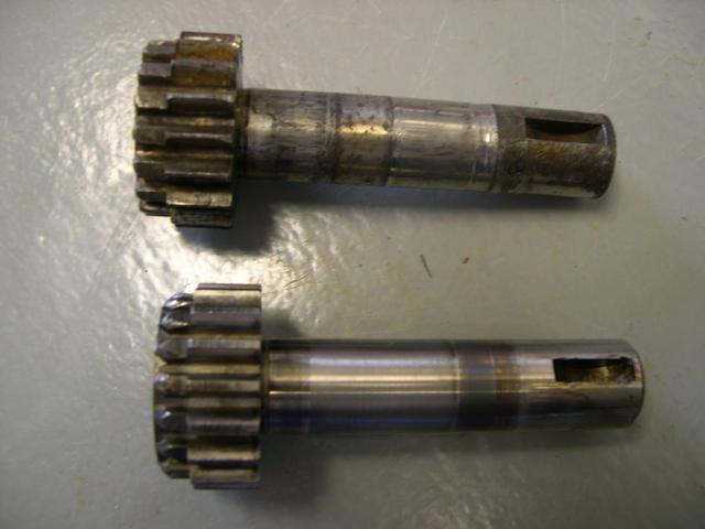

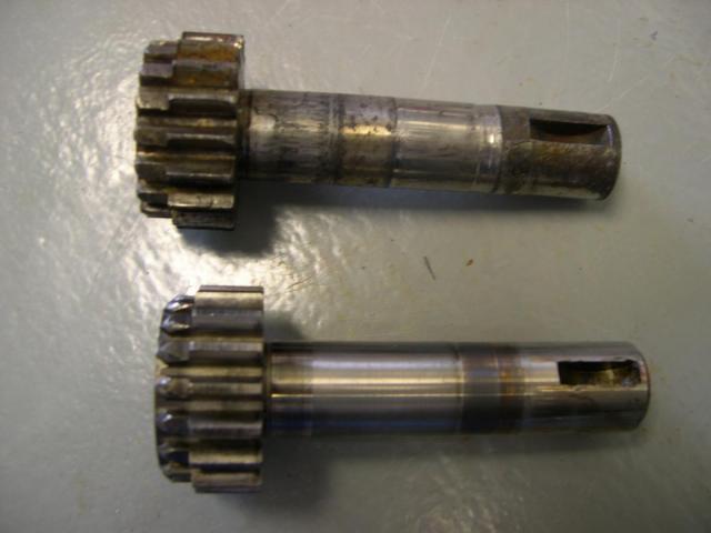

Racinbob 12,815 #33 Posted May 3, 2014 As I wait for a few parts to arrive I was taking inventory of what I have to reassemble the transmission. I’d like opinions on the input shafts I have. The shaft teeth that engage the 3523 are definitely better on the top shaft than the bottom shaft. But notice the larger teeth that are clearly better on the bottom shaft. The tops are ‘squared’ off and not as ‘pointy’ as the top gear. I believe the better choice based on the teeth condition would be the top shaft because of the teeth that engage the 3523. Your opinion? The 3523 gear I have is NOS so it’s pristine. Now look at the shaft itself. The lower shaft is clearly better. I haven’t polished either of them up yet but the worn grove in the top shaft is fairly deep. It’s a situation where I would search for a better shaft/gear if needed but if I’ll be fine with one of these based on the fact that this tractor won’t be ‘worked’ I’d rather not spend the money. The lower shaft is the one that came out on my transmission. I hope I’m wording this so it makes sense On another note. My wife went to the store this morning and, as usual, she asked me if i needed anything. I asked her to get some washing soda. She said "You mean baking soda?" "Nope, washing soda". She just said "OK, I'll try" and walked away with a funny look on her face. I didn't tell her it was for an e-tank. That would have confused her more. Share this post Link to post Share on other sites

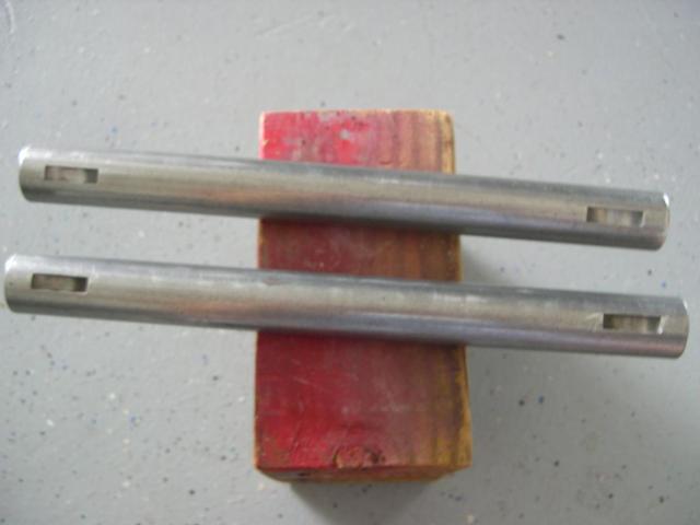

Racinbob 12,815 #34 Posted May 3, 2014 Christmas in May!!!! The mailman arrived just as my wife got home. I've got a box of washing soda from the wife and the mailman brought the SK8 bearing and a pair of beautiful axles. Thanks again Steve and Big Mike! A quick trip to the drill press and I can put the transmission back together. Well, after I decide what to do about the input shaft in the above post. Share this post Link to post Share on other sites
stevasaurus 23,627 #35 Posted May 5, 2014 Bob, I would go with the bottom input shaft. That is a deep groove in the top one, and I would worry about it leaking. With that NOS 3523 you have...you should be good in 3rd gear. Don't throw out that grooved input shaft...it can be spray welded and turned down to get rid of that groove. Share this post Link to post Share on other sites
Racinbob 12,815 #36 Posted May 5, 2014 Thanks Steve. That's what I'll do. I have the frame and transmission case all cleaned and the frame primed. Hopefully I'll be able to reassemble the transmission Wednesday and start making progress worthy of pictures. 1 Share this post Link to post Share on other sites

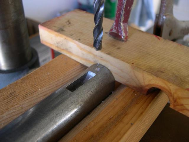

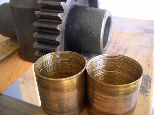

Racinbob 12,815 #37 Posted May 7, 2014 I rigged up a simple jig on the drill press and got the axles drilled out. I've never been accused of being too smart and I got reminded again this morning. The bronze bushings in the differential are shot. Now why didn't I check them out better before I ordered the axle bushings? Here's another option to get the bushings. Email Scott at bronzebushings@gmail.com and he will fix you up. He had the right length for the axles. I received them in just 2 days. I just ordered the diff bushings and the closest he had was 1 3/4" long. No problem. The bushings are the same price at $4.50 each. Shipping is $5.60 and if you're smarter than me (most likely) you won't have to pay that twice. My 1 1/8" socket was just the perfect OD for removing the old bushings. The axle that I cut off makes a great driver but it was easy to get them out. I had hoped to get the tranny back together this week but now I have to wait on the new diff bushings. Share this post Link to post Share on other sites
stevasaurus 23,627 #38 Posted May 8, 2014 I like the jig Bob...very cool. You will probably have to hone out those carriage bearings a little also. Great pictures. Share this post Link to post Share on other sites

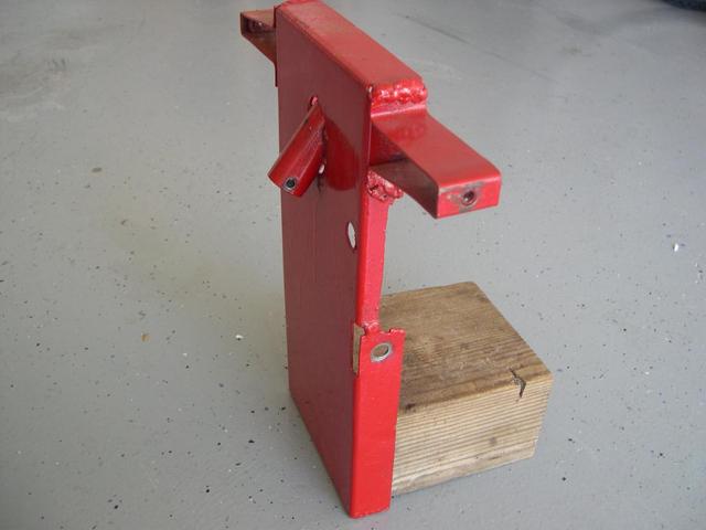

Racinbob 12,815 #39 Posted May 8, 2014 Thanks Steve. The 2x4 with the V groove is something that's lived next to my drill press for years. It seems like I'm always drilling something round. I just used an old axle to position the hole exactly the same and vice gripped the 1x2 on the end for a stop. If I get the bushings as fast as I did the axle bushings I should have the tranny and frame done by the end of next week. The tractor didn't entirely escape the cutting torch. The hood stand was attacked apparently to clear an air cleaner. It should be an easy fix though. I just got an email today saying that Terry has the decals on the way. Preliminary I know but I have the top plate and the control mount underneath ready to go and the decal has a (I think) neat little modification. I only have one control lever so I have been looking for some aftermarket controls that I could tear apart for the parts but no luck. I've decided to make two new levers using the original as a pattern. I see that Glenn sells the little plastic handles so I'll order a pair of them. Share this post Link to post Share on other sites
stevasaurus 23,627 #40 Posted May 9, 2014 Your excitement is contagious...very cool. If Glenn does not tell you this...soak the plastic handles in hot water for a few minutes (not long)...then place them in position...they will shrink on to the lever. Share this post Link to post Share on other sites

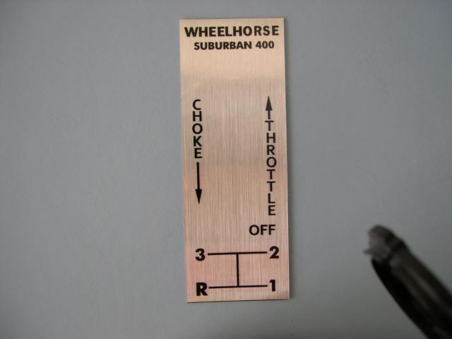

Racinbob 12,815 #42 Posted May 12, 2014 I'll be bouncing around on all the little details for this resto. I'm still waiting on the diff. bushings and once I get those I'll have the tranny back together and the frame/tranny all painted up nice. I'm going to running out of days to paint so I know I won't get the sheetmetal final painted until less humid days return. Have I mentioned that I hate Florida summers? I did get the decals I ordered from Terry today. What an incredible job!! Thanks Terry!! I have plans for the extras I ordered but that's down the road a ways. Take a look at the dash decal. Since my serial# was long gone I asked him to do this little modification. I likes lots! I've got the channel bracket and cover plate all painted up in steel. The original face of the cover was pretty pitted and then there was what was left of the factory stampings. I simply used the backside and it's as smooth as a baby's behind. I'll be making new levers and getting it rebuilt. That's just one of the many things that needs to be done as I wait for better painting weather. 2 Share this post Link to post Share on other sites

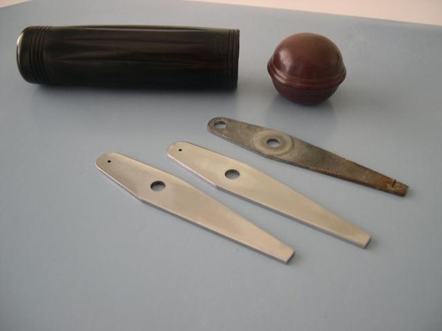

Racinbob 12,815 #43 Posted May 15, 2014 There was a UPS induced delay in getting the tranny bushings. So far they have been in 2 cities in MN, 1 in IL, 2 in TX and 2 in CA. How did they end up in CA? In the mean time I'm e-tanking parts and doing little things. The lift cable is cleaned up great. The lift handle had paint on it from the last 'restoration' so I cleaned it up. This morning I did the final shaping of the 2 new levers using the only original I had. I didn't drill the bottom holes to 1/4" because I don't want to commit how I'm going to attach the cables. The metal is .010" thicker than the original so now I need to get the knobs from Glenn in order to fit the levers to them. Once I get that done I'll do a final polish and clearcoat them. I'll also get a shifter knob from him. There were 2 with the tractor but I don't even think they started out life as a shifter knob. Share this post Link to post Share on other sites

Racinbob 12,815 #45 Posted May 19, 2014 Not much progress to report other than stripping the hood stand and tool box. I have a game plan for the hood stand repair that I can do with what I have available. I did receive the shifter ball and throttle/choke knobs from Glen today. Outstanding!! With my homemade levers being .010" thicker it will require just a touch of work for a proper fit but my quick test fit tells me there will be very little to do and then I'll use a little adhesive to make sure they stay in place. I also received the carriage bushings today so I'll be able to get the tranny back together. Unfortunately, another house project I got myself into this morning will keep me from playing until probably Thursday. 1 Share this post Link to post Share on other sites
