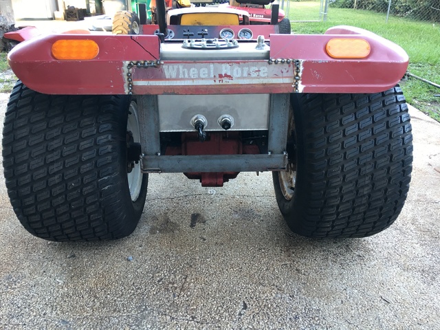

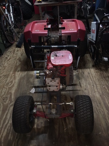

19richie66 17,692 #103 Posted April 20, 2016 (edited) Trying something a little different but familiar with the rear end. Edited April 20, 2016 by 19richie66 6 Share this post Link to post Share on other sites

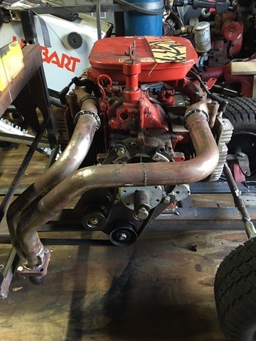

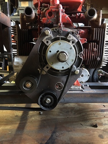

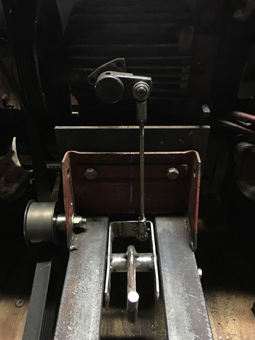

19richie66 17,692 #104 Posted April 27, 2016 I finished up the idler plate tonight. All I need now is the right belt. Header clears it well. 8 Share this post Link to post Share on other sites
Pullstart 67,230 #105 Posted April 29, 2016 Those headers would still let that V8 breath if you ever change your build mind!!!! Share this post Link to post Share on other sites

Stigian 1,234 #108 Posted May 8, 2016 It's good to see your back at this build Richie, the idler plate is a work of art Share this post Link to post Share on other sites
19richie66 17,692 #109 Posted May 8, 2016 Thanks. I am humbled. I don't know about a work of art but I did make it with my own hands. Just hope it works. I'm slowly plugging along. Going hydro made things a little easier for what I am doing with it. Share this post Link to post Share on other sites

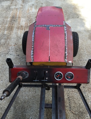

19richie66 17,692 #110 Posted June 10, 2016 Got the dash layout cut. Made my throttle and choke levers out of D-160 assemblies. I had to flip them around and trim off some of the bracket to get them to move in the right direction. I am going with an oil pressure gauge and voltmeter. I have a 3-1/2" teleflex marine tachometer in a pedestal that I am mounting on the column. I still have to finish the framework for the fenders, fab up a floor shifter, and make the seat mount. Little by little.... 5 Share this post Link to post Share on other sites

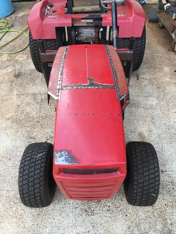

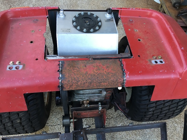

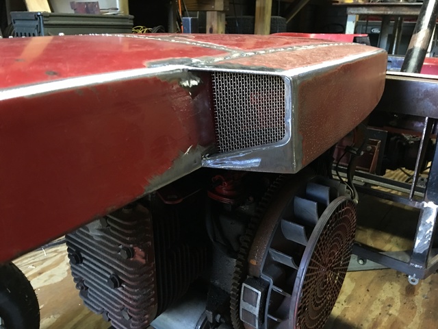

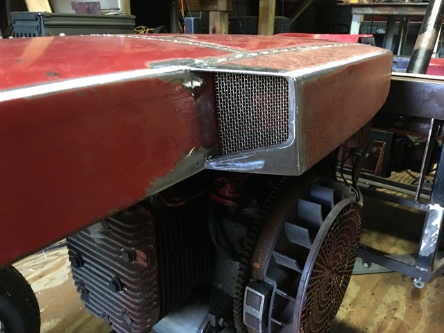

19richie66 17,692 #114 Posted June 20, 2016 Got the front of the hood scoops welded and shaped today. Still have some metal filing to do and seal up the bottom of the hood "wings", for lack of a better term. Both sides get mesh and the headlight opening too. Trying to get away with as little mud as possible in the whole hood. First time ever with metal working. 11 Share this post Link to post Share on other sites

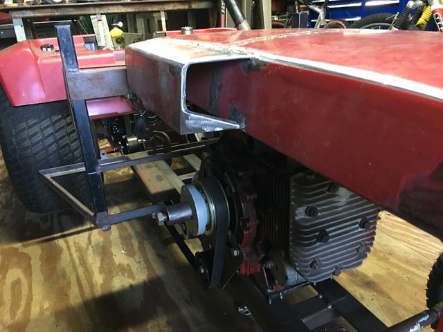

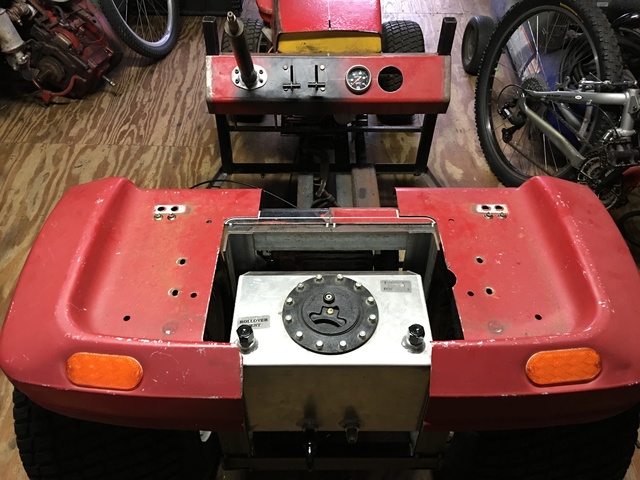

19richie66 17,692 #115 Posted June 24, 2016 Fender pan back to one piece. More hammering, grinding and still need to make the mounts. 9 Share this post Link to post Share on other sites
