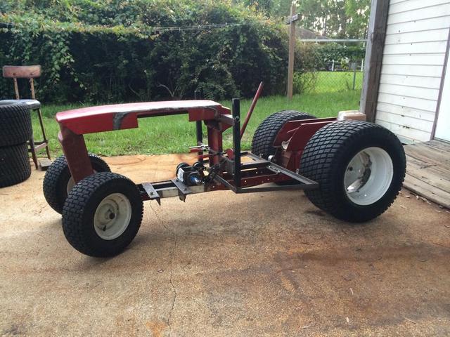

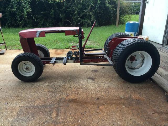

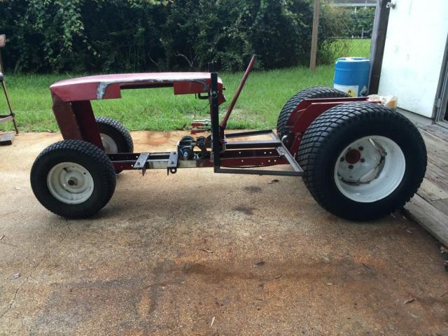

19richie66 17,669 #52 Posted September 18, 2014 Too low?......... Just right? Had to move some stuff around in the shed and that involved getting her off the table. Figured I would push it outside and get an idea of how it's going to sit. I have some new front tires on a wider rim so it wont have as tall of a tire in the front. I think I like it. 8 Share this post Link to post Share on other sites
Racinbob 11,997 #53 Posted September 19, 2014 I say it's good at is. Unless you plan on mounting a mower deck . Definitely not too low Richie. Share this post Link to post Share on other sites
AMC RULES 37,220 #54 Posted September 19, 2014 (edited) Yeah, nice stance... glad to hear about your Cub-ectomy too. Edited September 19, 2014 by AMC RULES Share this post Link to post Share on other sites
Stigian 1,234 #55 Posted September 19, 2014 Great work Richie, the proportions look spot on A nice bit of chassis rake as well, not too much, just enough Share this post Link to post Share on other sites

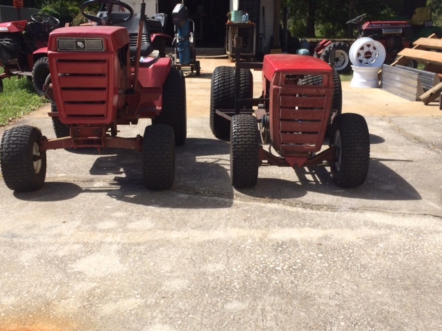

19richie66 17,669 #58 Posted October 13, 2014 Got the C81 running today and thought I would park it next to the roadster for a height comparison. I'm liking it! 4 Share this post Link to post Share on other sites
Coadster32 793 #59 Posted October 14, 2014 I like it too. Way cool Share this post Link to post Share on other sites

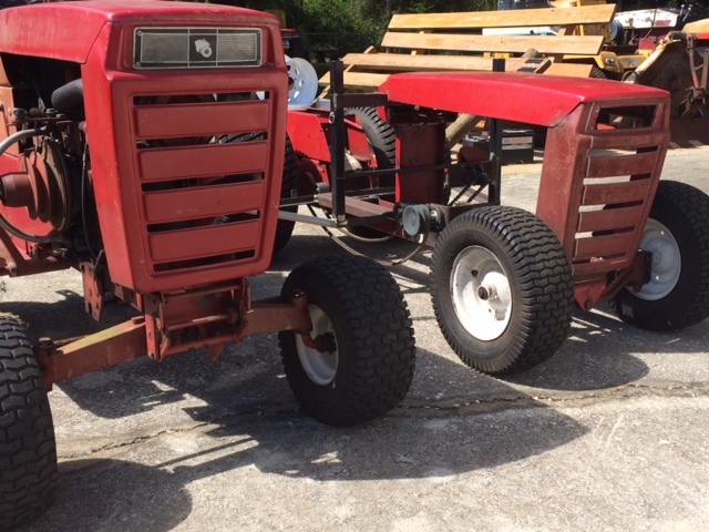

Aldon 4,828 #65 Posted October 22, 2014 I love the sound of the twin. 1 Share this post Link to post Share on other sites

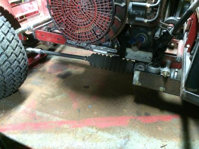

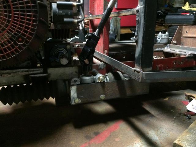

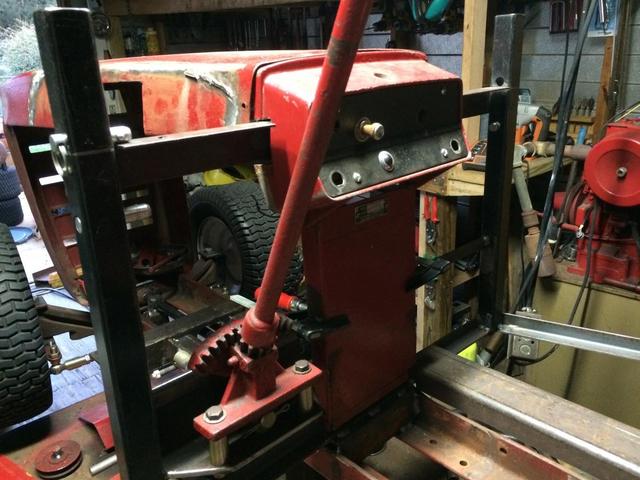

19richie66 17,669 #69 Posted November 1, 2014 Wasn't feeling the chain drive steering. Firewall flexed too much so I started digging in the parts bin and came across an old buggy rack n pinion from a project long ago that fizzled. I got to thinking how nice and simple it could be. Cut off the chain setup nice and easy so if I have to use it I still can. Had to mount the rack backwards so the throw would be correct. Just have to tidy up all the brackets and weld a couple more tabs on it. Also have to extend the steering rod about two inches. I hope it works. 6 Share this post Link to post Share on other sites
Muel 20 #70 Posted November 9, 2014 Very cool so far. Great stance. Share this post Link to post Share on other sites
Geno 1,929 #71 Posted November 9, 2014 Nice idea with the rack. Share this post Link to post Share on other sites

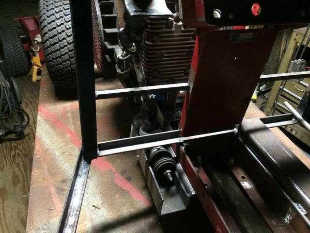

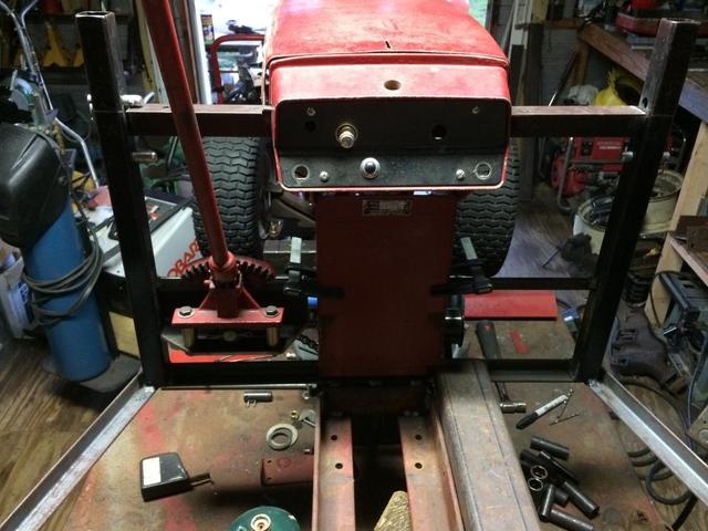

19richie66 17,669 #72 Posted November 14, 2014 Got the steering stop assy made. Used some old steering stabilizer parts from my daughters jeep and a piece of tubing. Little bit of measuring, tack welding and testing. So far this is what I have. Once I'm sure its going to work right, i'll burn it in and clean up the edges. 3 Share this post Link to post Share on other sites
Geno 1,929 #73 Posted November 14, 2014 Does it steer easy? Share this post Link to post Share on other sites
19richie66 17,669 #74 Posted November 14, 2014 With it sitting on the table it just has the weight of the motor on it so its hard to tell. It seems nice and easy and is about 2.5 turns from stop to stop. I hope to get it back on the ground next week. I had to move the nose out 5 inches to clear my tie rod bar and now I have to stretch the hood to match. Never ends. 1 Share this post Link to post Share on other sites
Coadster32 793 #75 Posted November 14, 2014 Great idea on the stops!! Share this post Link to post Share on other sites
