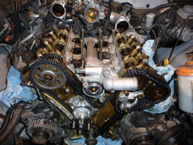

I'm an X-auto tech / state inspector (Currently in Mfg @ DuPont).  After the timing chain / tensioner / water pump install on Wifey's Suzuki V-6 SUV with (4) cams and (4) timing chains ...   I'm looking forward to spending time with the Onan.

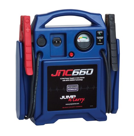

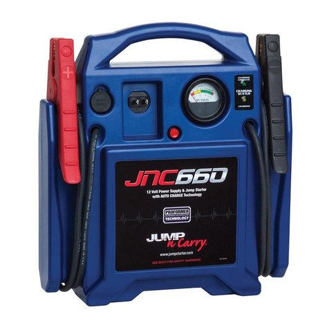

FYI:  Test drive = all systems go (Except for key start) and still no battery.  I hung the automotive JNC 660 jump pack on the PTO lever.
Deck not attached ~ New Deck Quill / Spindle / Hub assembly ordered.
