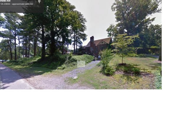

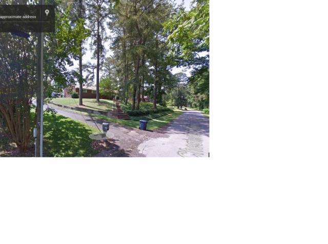

Whitfield 14 #45 Posted April 5, 2014 (edited) Yes, Wifey has the bug! Trying to talk her into cutting grass but she's not too excited about that prospect. I cut Granddad's grass today on his 2 year old Snapper High vac. 33" Disk drive.. Ugggh!!! Misery . Disk slips or tires spin ~ neither result in forward progress. Turning the wheel on the hill traveling up or down, is just a suggestion as the rear engine has no weight up front. Mower chassis (while made to flex) has the integrity of a wet cardboard box. I've gotta get the horse functional very soon. His yard is not huge but he is 91 and not able to cut any more. His neighbor cuts both yards with granddad's riding mower. Both yards are on a hill (Front and back). If I can get the horse up and running then his neighbor will keep on cutting. Fortunately the neighbor (retired school teacher) is anal about keeping the mower clean (compressed air and dry rags only) and in top condition. He stays on top of the minor maintenance. After today's adventure I'm wondering if I should be on the hunt for wheel weights... And I'm seriously re-weighing the Turf Master / All Trail decision (Need more traction but don't want to tear up the yard).. Pic 1 is from the east Grandad / pic 2 is from the west Neighbor (both are on extra deep double lots due to the hill) Edited April 5, 2014 by Whitfield Share this post Link to post Share on other sites
ericj 1,580 #46 Posted April 5, 2014 pictures can be deceiving, but those hills don't look like a match for a horse, wheel horse of course. ag tire or the atv tires should do good on the hills. i run ag tires on most of my tractors and don't think they tear up the yard any worse then turf tires d, maybe even less because they don't spin as much. now hook to something that don't want to move and you WILL dig ruts. i just bought my first set of atv tires but have not put them on a tractor so i can't comment on how well they will do, but they look like they should work real good eric j Share this post Link to post Share on other sites
