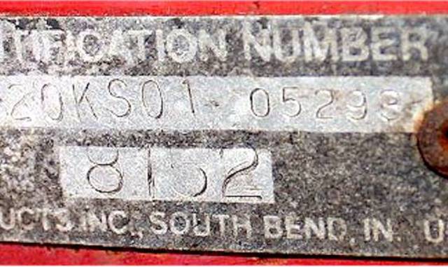

rtfbg 744 #1 Posted March 25, 2014 (edited) My ID tad has me confused ... it shows the "91" number on the upper line, which comes back mas a 79 model, but the second line show a build date of the 152th day of 1978. Thoughts??? Has anyone had to repair one or more of the hard lines in the transmission manifold setup? (the assembly with the two blocks welded to the 4 hard lines, pump to tranny) thanks!!! bob Edited March 25, 2014 by gulftane Share this post Link to post Share on other sites

gwest_ca-(File Mod) 11,592 #9 Posted March 26, 2014 My ID tad has me confused ... it shows the "91" number on the upper line, which comes back mas a 79 model, but the second line show a build date of the 152th day of 1978. Thoughts??? Has anyone had to repair one or more of the hard lines in the transmission manifold setup? (the assembly with the two blocks welded to the 4 hard lines, pump to tranny) thanks!!! bob Could you post the serial number on this ID plate? I see 0529_ Tractor production did start very early in 1978 for the 1979 models. Have seen a serial as low as 00048 for a C-81 but do not know the build date on that one. Serial 02109 has a build date of 8146 Friday May 26, 1978 - Another C-81 Serial 05207 has a build date of 8151 Wednesday May 31, 1978 - D-200 Auto Serial 05262 has a build date of 8152 which is Thursday June 1, 1978 - D200 Auto Serial 05293 has a build date of 8152 which is yours - D-200 Auto For most model years the early build dates were for attachments and the tractors followed likely because it would be easier to store attachments than assembled tractors. The 1979 models would have been released in October of 1978 like is done with the automotive industry today so they had to get an early start. Build dates are not the actual day they built the unit. It is the date that batch of units with their serial numbers was scheduled to be built. Garry Share this post Link to post Share on other sites

rtfbg 744 #11 Posted March 26, 2014 Garry ... that's what I see, 0529. After a meeting with the welder and the hydro gooroo, we have a plan. Cut the hard lines near the manifold blocks, and weld on regular steel pipe fittings, then fabricate soft lines to fit each set. Two are 5/8 and two are 1/2. I think it will work fine. Purpose is to facilitate an 18 inch frame stretch. bb Share this post Link to post Share on other sites

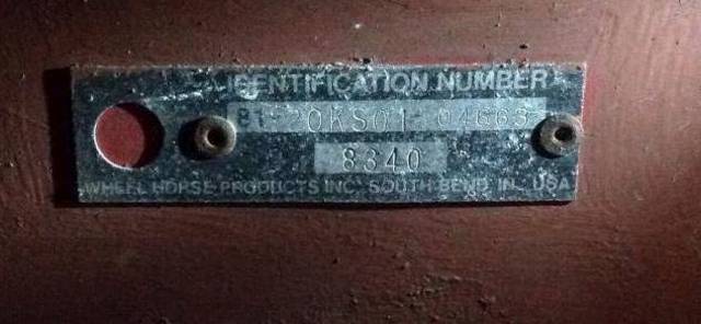

wheeledhorseman 579 #12 Posted March 27, 2014 (edited) Garry, here's another D-200 from 1978 81-20KS01 serial 04663 build 8340 I'll get the details of mine (also in the UK) tomorrow. Andy Edited March 27, 2014 by wheeledhorseman Share this post Link to post Share on other sites
gwest_ca-(File Mod) 11,592 #13 Posted March 27, 2014 Garry ... that's what I see, 0529. bb Looks like a 3, 8 or 9 following the 9 in the photo. Share this post Link to post Share on other sites
gwest_ca-(File Mod) 11,592 #14 Posted March 27, 2014 Garry, here's another D-200 from 1978 plate.jpg 81-20KS01 serial 04663 build 8340 I'll get the details of mine (also in the UK) tomorrow. Andy Not uncommon to see an incorrect build date. I think the person doing the stamping did not understand the Julian calender. They were stamping a 1978 plate in 1977 so used the 8 for the year. This happened a lot and shows up easier now that the list has grown. This should be 7340 which is December 6, 1977. The highest 1978 serial recorded for the 1978 model year is 20265 with build date 8144 (May 24, 1978) for US production. This one looks like a USA build. On 8340 they would have been building 1979 models. The 1978 Belgium built serials so far range from 162416 to 165051. Garry Share this post Link to post Share on other sites
rtfbg 744 #15 Posted March 27, 2014 Yes, I see that also, but it seems like a lighter strike than the other numbers. Also, that would indicate a rather significant number of units produced by this early date. I didn't know they made that many D's, let alone by the summer before they were intro'd!!v interesting!! Share this post Link to post Share on other sites
wheeledhorseman 579 #16 Posted March 27, 2014 With a bit of enhancement, like Garry - I'd say that's a 3 Andy Share this post Link to post Share on other sites
gwest_ca-(File Mod) 11,592 #17 Posted March 27, 2014 Yes, I see that also, but it seems like a lighter strike than the other numbers. Also, that would indicate a rather significant number of units produced by this early date. I didn't know they made that many D's, let alone by the summer before they were intro'd!!v interesting!! Lower serial numbers than yours could have been attachments. They likely built 2 or 3 attachments for every tractor built so they would add up quickly. Have never seen a serial number duplicated within a model year. The 1978 USA serial numbers likely started a 00001 and the highest recorded so far is 20265 so that is a lot of product if they used most of the numbers. I am sure some got missed by the way it was done. Garry Share this post Link to post Share on other sites
gwest_ca-(File Mod) 11,592 #18 Posted March 27, 2014 With a bit of enhancement, like Garry - I'd say that's a 3 sharpened.jpg Andy You have better results than I got. Sure looks like a 3. Thank you. Garry Share this post Link to post Share on other sites
rtfbg 744 #19 Posted March 27, 2014 Ahhh ... see I never ASSumed they would assign the same series of ID numbers to attachments. Now it makes a lot more sense. Yea, I vote for a 3 also. Love my Canon with the macro setting, you can really get some detail!! lol not so good on some of my relatives though!!! yuk!! Share this post Link to post Share on other sites
