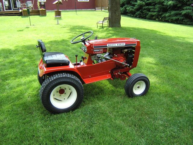

Rick_in_CT 156 #5 Posted March 21, 2014 (edited) Sunrise Red was a good match for my application, but as said, others find that Regal Red works for them. I have had good luck with the Rustoleum on both a plow and snow blower. Edited March 21, 2014 by Rick_in_CT Share this post Link to post Share on other sites

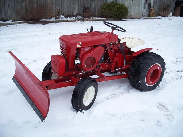

Tankman 3,523 #14 Posted March 22, 2014 (edited) Regal Red. Easy to work with, I use the rattle cans. Sometimes I coat with clear crystal after the Rustoleum Regal Red has dried for a few days..or longer. Foot rests get skateboard heavy duty grip tape. Great stuff! Edited March 22, 2014 by Tankman 3 Share this post Link to post Share on other sites

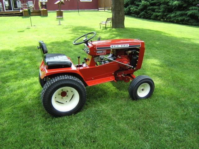

pacer 3,177 #19 Posted March 22, 2014 Sunrise red here - I was a big fan of Valspar til it died. I have found the Rustoleum to be very available - wally world, home depot... - inexpensive, comes in rattle can or bulk and I thinkis a pretty forgiving paint. Takes about 24hrs to handle, but really needs several days to dry dry and then is pretty bomb proof. Frankly I'm a bit surprised at the number of Rustoleums users here - wasnt long ago most of these would be TSC/Valspar users (including me) Here a couple of Sunrise red with almond wheels... 2 Share this post Link to post Share on other sites

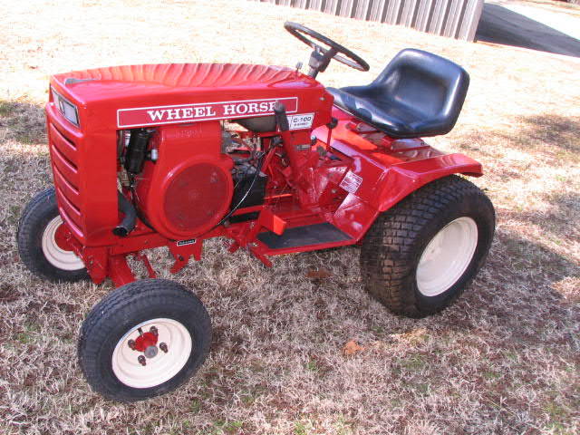

Digger 66 3,488 #20 Posted March 22, 2014 Here's the Regal on my "freshened-up" worker : 1 Share this post Link to post Share on other sites
