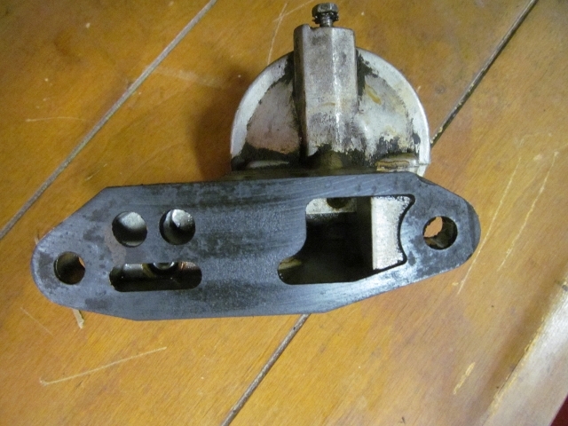

Ed Kennell 43,815 #16 Posted March 20, 2014 On sale @ NAPA for $2.19. Kyle, Another potential leak is the oil drain pipe. Mine was also loose, and the 90 deg ell will not allow you to tighten them without removing the engine . I cut mine off to get it out and replaced it with a straight 4" nipple and cap. Now I can tighten it any time. Just need to make a foil trough when draining the oil... I usually do this anyway. New drain Filter bracket Share this post Link to post Share on other sites

Theroundhousernr 590 #21 Posted March 21, 2014 Well I did some cleaning on the 520. The heavy grease is gone. Just need to do the final cleaning to make it shine. It's funny you mention that Eric. I couldn't find the leak in the fly wheel side so I had my fellow wheel horse nut stop by. He saw a problem right away. The oil filter was the wrong one and not sealing on the housing. He ran home and got one for me. The filter he use is a little taller than the original but the same circumference. I'll post a picture so you guys can see the difference. It's evident that the leak on the flywheel side had been there a long time. I wonder how long the OP was using the wrong filter. Here is the tractor ready to roll outside to get washed for the final assembly. Sent from my Event using Tapatalk Share this post Link to post Share on other sites
ericj 1,579 #22 Posted March 21, 2014 my 518 had an onan filter on it just not tight eric j Share this post Link to post Share on other sites
Theroundhousernr 590 #23 Posted March 21, 2014 I just thought it was interesting. The smaller filters barely makes contact with the inner sealing surface of the housing. It's tight though. Hopefully tomorrow I can get her running and hopefully have a good block to work with. Then I'll check heads, valves and reseal intake gaskets. If not, later in the spring/ summer you will be seeing an onan rebuild thread lol. Sent from my Event using Tapatalk Share this post Link to post Share on other sites
