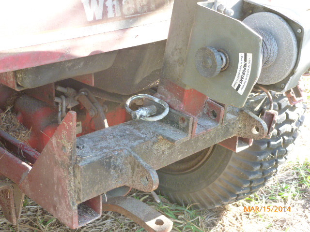

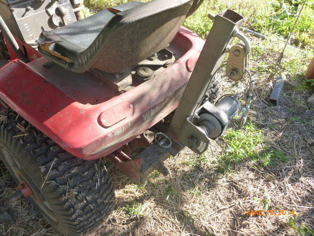

over60pirate 24 #1 Posted March 16, 2014 A member PM'd me and asked for a pic of my rear winch mount. Couldn't see how to PM a picture, so here they are. I built on to the hitch mount the PO made. His has Unistrut (I think. It's open on one side) bolted on top of rear axle, using longer bolts, that also attach the rear axle plow mounts. If redoing that part, I would use 1 1/2" sq. tubing. I've been using the GT and she sure needs a wash! 2 pins attach the winch. Only 1 is being used in pic, which is why it isn't vertical. I have the same mount on the front of the tractor. Also have a attachment for front or rear, which has a 1' barbell bar, sticking out to add weights to. The 2, taps on the rear are for attaching my back blade, lifting boom, etc Not sure if pics will work. . 2 Share this post Link to post Share on other sites
Joefrommi65 26 #2 Posted March 16, 2014 Just what I was looking for thank you very much Cliff!!! Share this post Link to post Share on other sites
over60pirate 24 #3 Posted March 16, 2014 "taps" on rear, should have read "tabs" Share this post Link to post Share on other sites
Tankman 3,528 #4 Posted March 18, 2014 Very nice! I see an early spring project on my "to do" list. Thanks again for posting. I'm sure more thanks'll follow! Share this post Link to post Share on other sites
