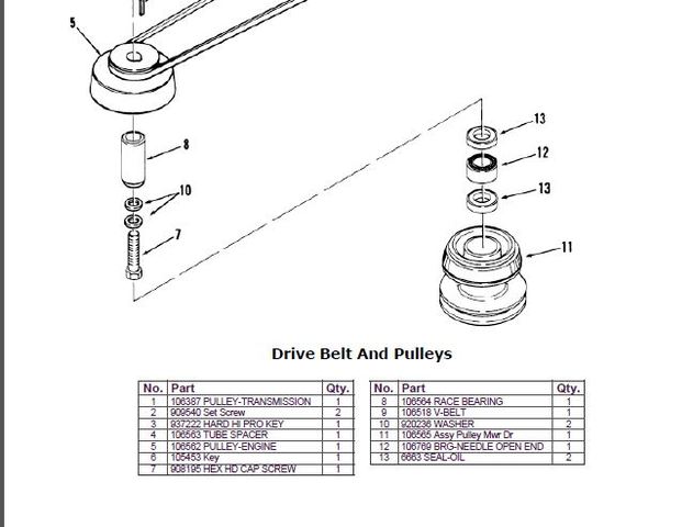

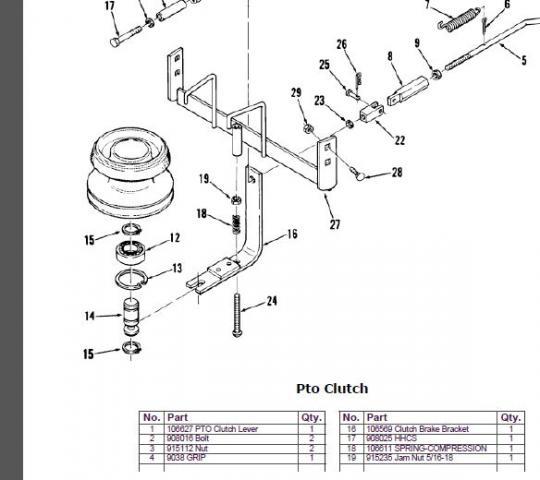

Hi !! Can anyone help me with a number or measurment on bearing nr 12 in first picture below, and bearing nr 12 in the other picture below ?? and also sealings nr 13 ??

Toro 5196 has been replaced by 109842
Bearing Ball .750"x1.781"x.610"
Rotary 484, Stens 230-033, Stens HD 230-037, Napa 7-04250, Generic 9504AB
This one is a guess
Toro 106769
Bearing Needle 1.500"x1.875"x1.250" Caged Open
It may be a Torrington J-2420
Take the old ones with you to a supplier for comparison. There may be numbers on the ends of the bearings that would be a big help.
Garry
Sorry - forgot the seal
Toro 6663
Seal 1.500"x1.878"x.250" CR
Chicago Rawhide or SKF number 14810
Should add that the original seal may be a different width or thickness. I got these dimensions from a Chicago Rawhide catalog and that is the seal they replace the Toro 6663 with.
