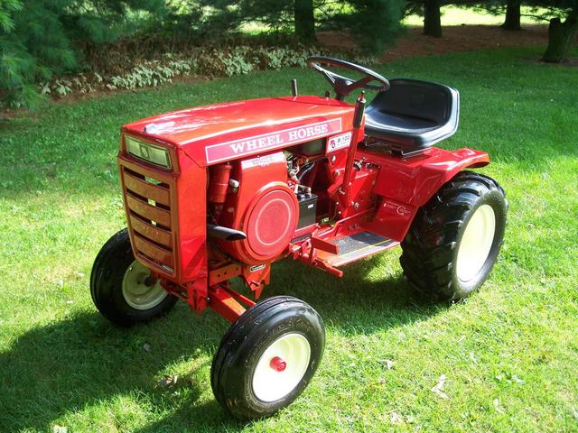

Kelly 1,036 #3 Posted March 10, 2014 (edited) in the 60's they made a few 8hp hydro's 875, 876, 877, but newer than 67 they did not offer it it in a horizontal shaft machine, but I built a tractor for my son it was a B-100 auto I installed a 8hp in it for the first 5 years, it never mowed but he did pull stuff with it no problem. Everything was a bolt in, using B-80 parts, except the hydro pulley that was hard to find, only used on the work horse's with the briggs twin in them. Edited March 10, 2014 by Kelly Share this post Link to post Share on other sites
Kelly 1,036 #4 Posted March 10, 2014 (edited) Here is his B-100 auto, / B-80 auto as it sets here It now has a 12hp in it with 10hp decals but looks correct, here it is as it sets now with the bigger engine. Edited March 10, 2014 by Kelly 5 Share this post Link to post Share on other sites

Jparkes43 329 #6 Posted March 10, 2014 Here is his B-100 auto, / B-80 auto as it sets here It now has a 12hp in it with 10hp decals but looks correct, here it is as it sets now with the bigger engine. 100_4073.JPG wow i want one Share this post Link to post Share on other sites
KC9KAS 4,745 #7 Posted March 10, 2014 Kelly, that is a very nice looking B-80, or B-100, or currently a B-120! 2 Share this post Link to post Share on other sites
Kelly 1,036 #8 Posted March 11, 2014 Well from the outside you can't tell a10hp from a 12hp so it has 10hp decals to look correct, and Thank you, my son is proud of it, it was built in 6 weeks along with another tractor, nights after work and weekends Share this post Link to post Share on other sites
