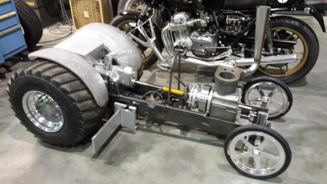

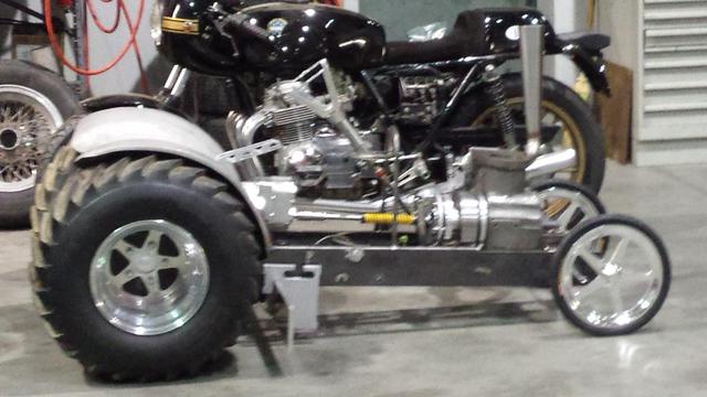

chris11 184 #66 Posted October 19, 2014 sitting in my shop, still need to make more body work. Engine sitting in there for mock up. 4 Share this post Link to post Share on other sites

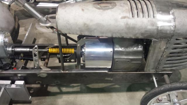

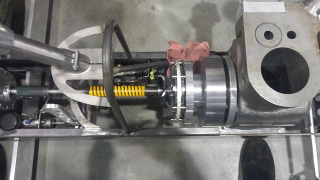

chris11 184 #69 Posted January 25, 2015 A few up dates drive shaft and clutch set up 6 Share this post Link to post Share on other sites

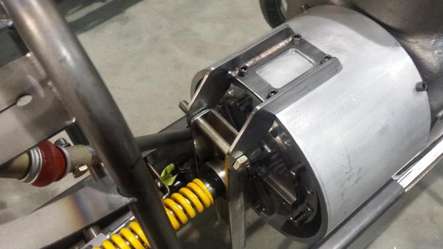

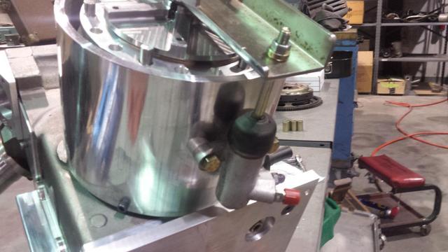

chris11 184 #75 Posted February 3, 2015 Got the blow shield done. made from 8 inch ID aluminum tube with a .312 wall. That should stop anything that gets throw at it. I HOPE. any way I incorporated the clutch pivot and a clutch slave cylinder. so its a clean and easy way to work on. 3 Share this post Link to post Share on other sites
