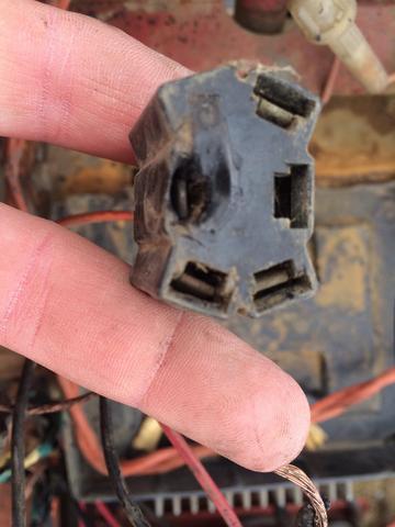

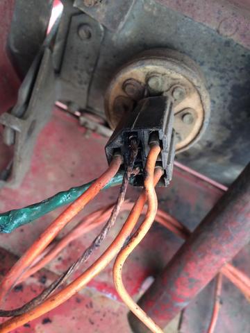

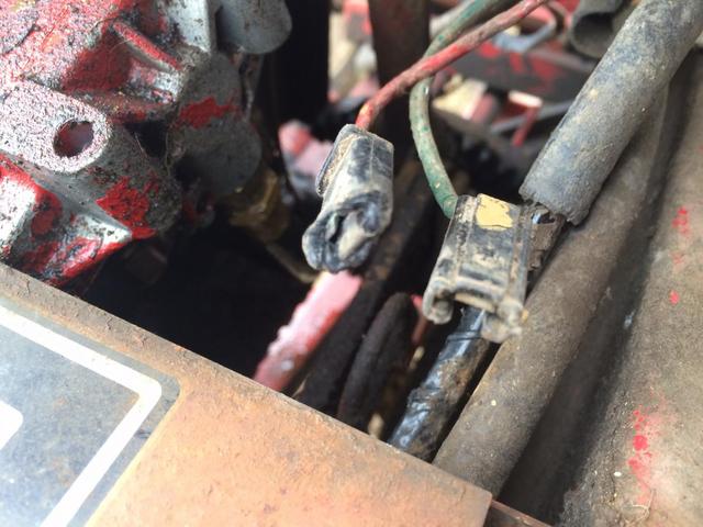

876wheelhorse 46 #3 Posted February 23, 2014 (edited) Is this a standard relay gonna repair the wiring that's bad if don't work out then it's going to graveyard Looks like wire from switch to relay is prob totally gone and possibly what started just a guess Edited February 23, 2014 by 876wheelhorse Share this post Link to post Share on other sites
Sparky-(Admin) 24,546 #4 Posted February 23, 2014 Usually a full melt down like that indicates a "bypassed" fuse or a fuse that was rated way to high. I would definitly be trying to find out what started it in the first place. Might want to add an in-line fuse in your system....cheap insurance.. Mike......... Share this post Link to post Share on other sites

farmerall 23 #6 Posted February 23, 2014 Someone may have hooked the battery up backwards too. I did that once and ended up have to replaced 20 feet of wire because two wires melted together. 1 Share this post Link to post Share on other sites

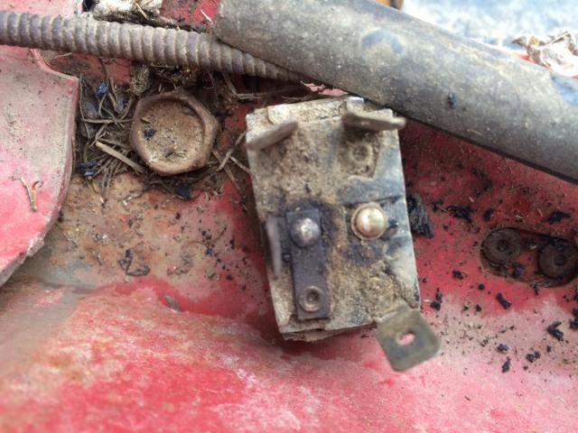

doc724 925 #11 Posted February 23, 2014 876Wheelhorse; That item in your pix is not a relay at all. It is a switch that is actuated when you engage the PTO (so that when you get off the seat the PTO shuts off). Replacements are crazy expensive like $64. I bought a used one from Joe's Power for like $14. Cutler Hammer makes them but they are not in stock and lead time to build is 8 weeks. Send e-mail to Joe or to Kelly to see if there is another. Regarding the root cause for why the switch terminals burned? Based on what I see, either there was a short circuit in that line or the female terminal was not gripping the switch tightly enough. This resulted in high resistance at the connection. The high resistance generates heat which just makes matters worse before everything goes poof. If you ever had an electric stove with those spiral calrod heating elements, usually the burner that got the most use would fail first. The heating element was usually not the item that would fail, it was always the connector. Share this post Link to post Share on other sites
876wheelhorse 46 #12 Posted February 24, 2014 So this thing that's not a relay can I do away with? I'm doing away with seat an clutch switch and this doesn't have a deck..... Share this post Link to post Share on other sites
Kelly 1,037 #13 Posted February 24, 2014 Yes that is a safety switch for the PTO, can be eliminated, if you want basic wiring with out the safety switches wire it like a 1970 Raider 12 that should get you what you want, junking a good machine because of a wiring melt down ??? 1 Share this post Link to post Share on other sites
876wheelhorse 46 #14 Posted February 27, 2014 Yes that is a safety switch for the PTO, can be eliminated, if you want basic wiring with out the safety switches wire it like a 1970 Raider 12 that should get you what you want, junking a good machine because of a wiring melt down ??? Gonna try rewire it just the wires that go to ignition switch rectifier wire battery coil starter lights that eliminate the seat and clutch wiring but I'd like to somehow wire in the clutch. Stumped on that cause that wiring currently goes into the pto switch that's going by by.... Any ideas Share this post Link to post Share on other sites
