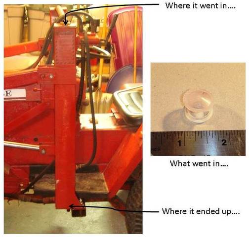

jdmitchjr@6dlam.com 5 #51 Posted March 11, 2014 I am a bit surprised that my plastic pull tab in loader reservoir event did not get more attention. For those not familiar with the Ark loader, the reservoir is the hollow rectangular vertical support. The attached image shows the dilemma. Three openings all about a half inch in diameter -- fill, supply to pump, and drain. I advise against making this mistake.... Best regards, John Share this post Link to post Share on other sites
JamesBe1 84 #52 Posted March 11, 2014 John, I don't thing that plastic cap is standard issue. At least on mine, there is a hex nut with a tiny vent hole in it. My FEL is under a tarp buried under snow at the moment or I would snap a pic. Hopefully one of the other guys can chime in to confirm or deny. j Share this post Link to post Share on other sites
jdmitchjr@6dlam.com 5 #53 Posted March 11, 2014 James, the plastic top came from a pre drain hydraulic additive (it helps remove water). The cap on the FEL is steel with a vent. But mine was missing the o-ring, so that is probably a source of water entry. B/R John Share this post Link to post Share on other sites
