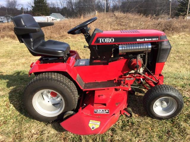

608KEB 812 #1 Posted February 20, 2014 I have a 94 520H. I want to put the factory front tires that came on the tractor. Were they goodyear softtrac tires? I have a manual and found the front tire size. (16X650-8) Also were these tires 2 or 4 ply? 1 Share this post Link to post Share on other sites
Kelly 1,035 #2 Posted February 20, 2014 All the 520s I have owned none had Goodyears on them, older ones had Carlisle Turf savers on them newer had Dico R/S I think is the model, but Dico for sure 1 Share this post Link to post Share on other sites
cleat 8,206 #3 Posted February 20, 2014 I believe you should have 16x7.50-8 tires up front and 23x10.5-12 tires out back. Mine were this size on my newer swept axle 520. Front tires on mine were 2 ply. Cleat Share this post Link to post Share on other sites
Digger 66 3,489 #4 Posted February 20, 2014 I would fall asleep in that seat . 1 Share this post Link to post Share on other sites
AMC RULES 37,251 #5 Posted February 20, 2014 Like riding your sofa around the yard. Share this post Link to post Share on other sites

wh5208speed 669 #12 Posted March 2, 2014 Dico got bought out by Titian, which got bought out by Carlisle. Here is a website that sells them: http://www.cedarrapidstire.com/category/15512/turf-trac-r-s-carlisle-lawn-and-garden-turf-tires Carlisle still makes the 23x10.50-12, but they do not make the 16x7.50-8 (unpopular size), which came on the fronts. You could substitute 16x6.50-8 (very popular size) which would fit just fine on the rim. Thad (Ohio) 1 Share this post Link to post Share on other sites
