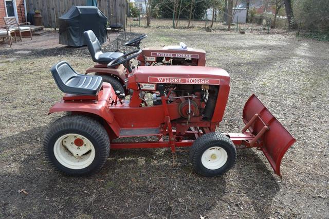

limited12 360 #1 Posted February 20, 2014 I just picked up a b-100 (1976) with no deck, i have a rear discharge deck (36") serial number 85-36mr01-08078, my question is i can not find out what drive belt it takes, the deck belt i have, it is a wheel horse 8411 Thanks in advance for everyones help 1 Share this post Link to post Share on other sites
gwest_ca-(File Mod) 12,012 #2 Posted February 20, 2014 8411 is the correct spindle belt Drive belt Toro 102741 {HA/Ax96.6"} 6638BR Gates 17/32"x96-3/4" Wrapped 6638BR Napa 17/32"x96-3/4" Wrapped Garry Share this post Link to post Share on other sites
limited12 360 #3 Posted March 3, 2014 Thanks Garry, picked up the belt from Toro, 22.00, put everything on yesterday. Thanks again Share this post Link to post Share on other sites
