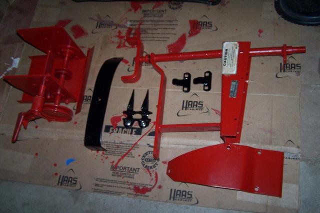

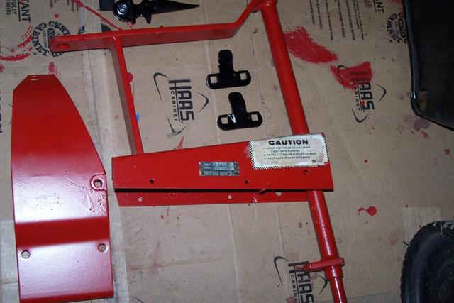

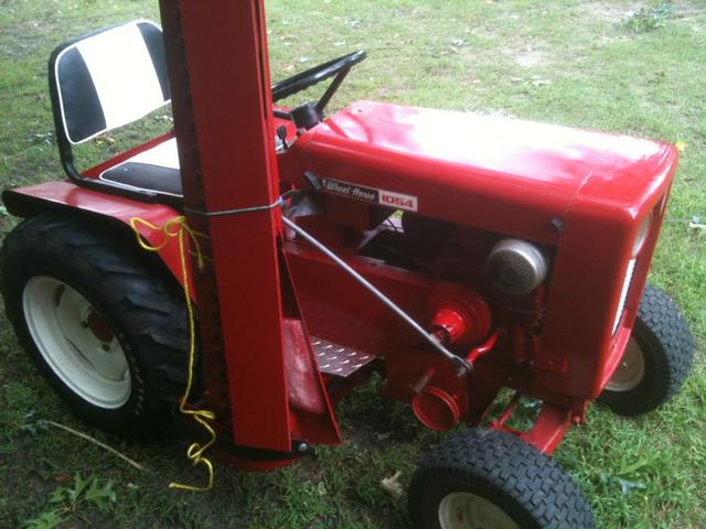

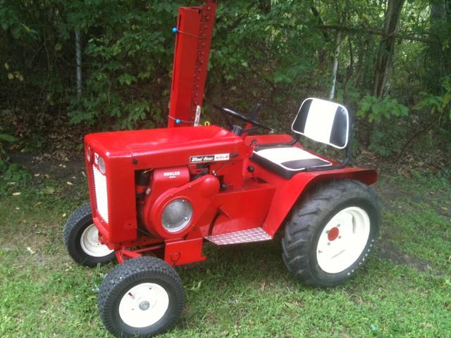

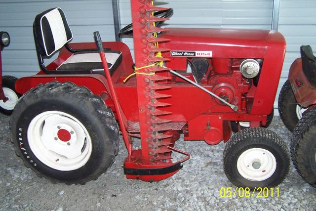

Lane Ranger 11,512 #14 Posted February 23, 2014 (edited) Here is our SMS-50 Sickle Bar Mower on our 1965 -1054-A tractor. [ These parts are from a 50 inch sickle bar mower but this is a Model 7-1312 . The U Shaped piece on the end of the bar is where you bolt up the sickle bar on the back of the tractor -in front of the transmission. The SMS-50 does not have this type of "bolt up" and instead has a plate that bots to the back side of the tractor (or front of the transmission actually). Edited February 23, 2014 by Lane Ranger 1 Share this post Link to post Share on other sites

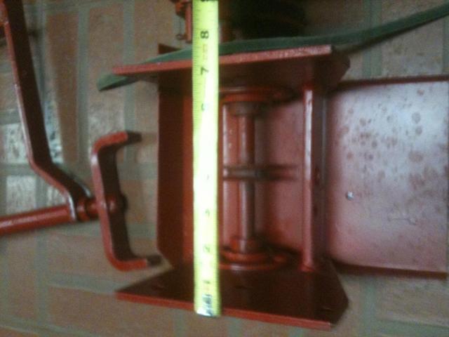

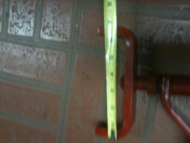

Lane Ranger 11,512 #18 Posted February 24, 2014 I always learn a thing or two from each of these implement postings! I did not know that the 50 inch sickle bar mowers had two different sized frame plate mounts! Here are a couple photos of the 50 inch sickle bar mower frame (7-1312) that I noted above. Just like Evanloock indicates above their are two different sized 50 inch sickle bar main frame setups. The SMS -50 is wider and the 7-1312 is more narrow for different applications. The large main frame rests outside the frame of the tractor and two nuts and bolts on each side hold it in place. The second photo shows the rear bar that rides between two bolts in front of the transmission where the angled pieces come off the frame of the tractor in front. 1 Share this post Link to post Share on other sites
