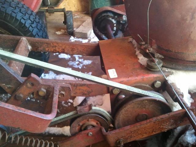

horse junkie 18 #1 Posted February 19, 2014 I just picked up and older 32" snow blower ( have no idea what the model # is ) but from pictures I've looked at it's a 6-2211. I mounted it on my 1277 everything is working and hooked up fine. Only problem it's pushing the snow instead of pulling it in any help or suggestions greatly appreciated. Thanks Share this post Link to post Share on other sites

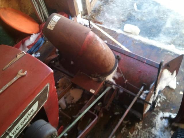

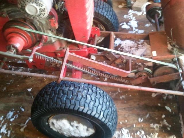

horse junkie 18 #5 Posted February 19, 2014 pics attached Share this post Link to post Share on other sites

Kelly 1,037 #7 Posted February 19, 2014 Well for one that blower is not for that tractor, it's for a earlier one, with out a engine mounted PTO, but still should turn the right way, and that blower does not use the top idler sprocket, you also have the belt on wrong you have the back of the belt running on a V pulley, and the V part on the flat pulley, but still should be turning the right way, lets see a pic of the chain. Share this post Link to post Share on other sites

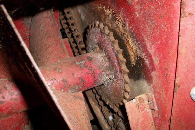

gwest_ca-(File Mod) 12,012 #8 Posted February 19, 2014 This may better show how the idlers were intended to work. Garry Share this post Link to post Share on other sites
horse junkie 18 #9 Posted February 20, 2014 I now know the blower is for an earlier style tractor, when I purchased it the gentleman told me it came with his C-121. This is what you get when you purchase something 40 yrs. old from a guy who sold a Wheel Horse and bought a Tractor Supply Cub Cadet. The chain on this blower simply runs around the outside of three sprockets, I tried to upload a picture of the chain but said was to big to upload. I believe the problem is that it is for a non pto style tractor. From lokking at the manual for 6-2211 there is actually a lever missing that goes through the hole next to the rod for the chute, pretty sure the missing rod was used to engage the blower originally. Share this post Link to post Share on other sites

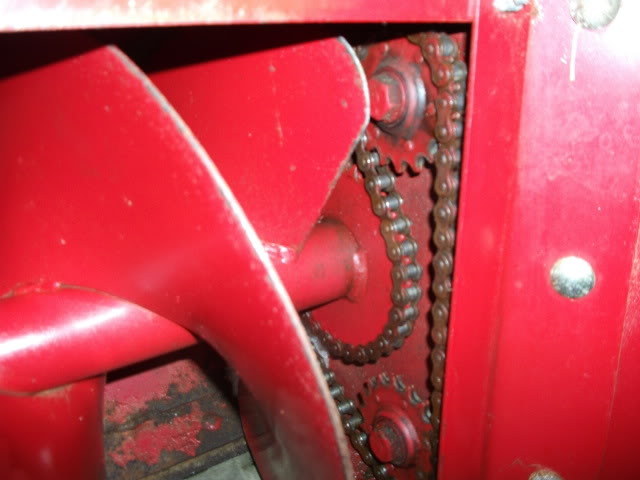

Kelly 1,037 #14 Posted February 20, 2014 Here is the early chain set up, sounds like yours is routed wrong, you can add the upper idler, you get better chain contact with the big gear, but it will work as I have pictured, this is of my early blower I use on my round hood. And yes there is a rod missing that runs the blower mounted PTO but not needed as you have the engine PTO Set you chain up like this and you should be all set. 1 Share this post Link to post Share on other sites
horse junkie 18 #15 Posted February 20, 2014 O.K. Thanks to everybody for your responses, and Kelly thanks for the final picture I was just trying to figure how the chain would run, your picture is exactly what I thought but it seems like the chain would fall of the auger sprocket. I will figure it out maybe I'll add the fourth sprocket as Kelly said would make better contact with the auger sprocket. Once again thanks to everybody for their help. Share this post Link to post Share on other sites
Kelly 1,037 #16 Posted February 20, 2014 if the chain is tight it works fine, I have used this one for a few years. If you add the upper idler you will need to mod the chain guard but you will see that. Share this post Link to post Share on other sites
