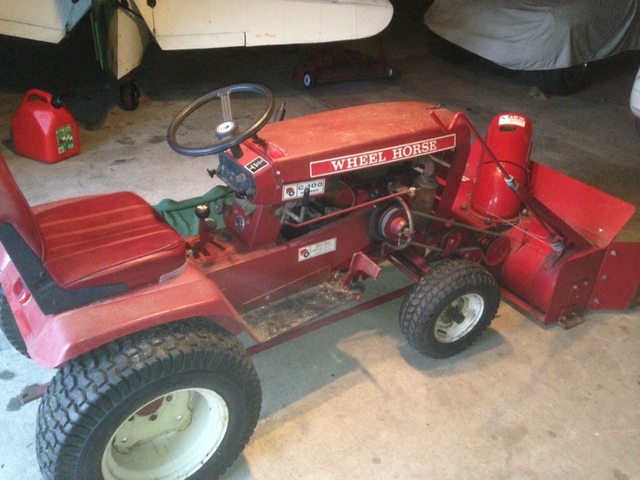

Irish Rover 14 #1 Posted February 18, 2014 Hi everybody... I am a new member to R.S. I have recently picked up a 1975 C-100 and a single stage snow blower (I don't know the model #) for $350. I bought it to clean up around our small airport in West Michigan. The maintenance guy at the airport has created a mess around our hangars with his questionable plowing practices. I would like to attack the windrows over the next couple days so the warmer weather can have a chance to help with the snow. The windrows are not huge, but I was wondering if there is a best practice to clear them. I am assuming I will have to bust them up with a shovel and then blow the knock down away. I don't have a plow. I thought it wouldn't hurt to beg for some tricks. Casey C-100 2 Share this post Link to post Share on other sites

Hodge71 665 #3 Posted February 18, 2014 (edited) Casey, with it being an 8 speed I would say the best way to attack it is head on. No need to bust anything up with a shovel unless you are dealing with solid Ice and then you shouldn't be blowing it anyhow. I would say best thing to do is run at full throttle, put the transmission in low range and start out in second gear. Put the pile right in the middle of the blower and chug through it. If its too fast and bogging the engine horribly, drop to first gear. Just be patient. Your tractor has a Kohler…Its a good engine and it will chew through your mess. Post some pics too, before, after, action shots during…we are suckers for pics and vids. Good luck and Edited February 18, 2014 by hodge71 1 Share this post Link to post Share on other sites

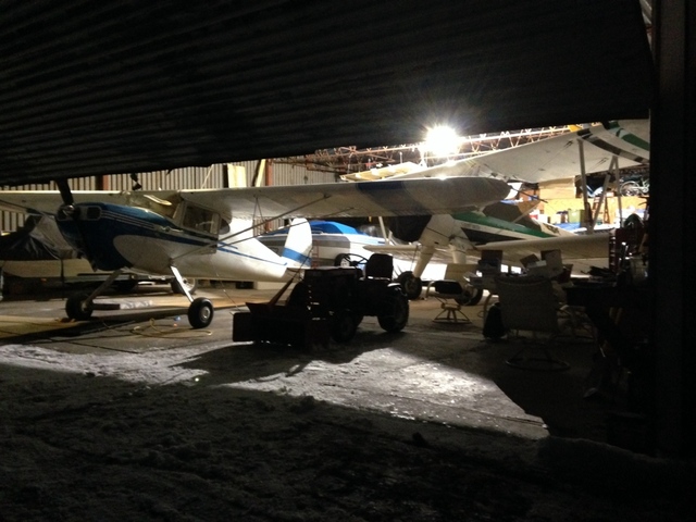

Irish Rover 14 #8 Posted February 19, 2014 I have chains mounted but no weights. So far I have had good traction with just the chains. I got most of the area cleaned up tonight. Here is a picture of the horse sheltered under a friendly wing. Casey C-100 Casey C-100 1 Share this post Link to post Share on other sites

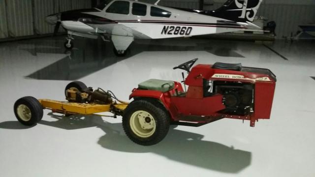

Irish Rover 14 #15 Posted February 19, 2014 New Ags going on soon Casey C-100 2 Share this post Link to post Share on other sites
boovuc 1,090 #16 Posted February 20, 2014 Ahhhhhh. Your horse is making friends with a Cessna! Share this post Link to post Share on other sites

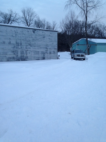

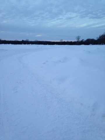

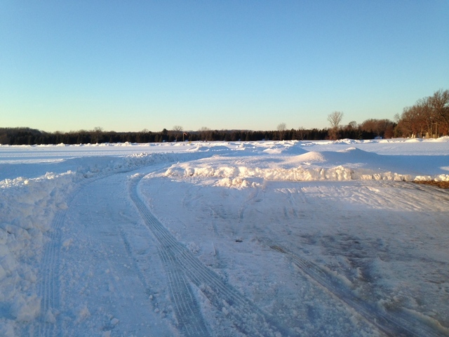

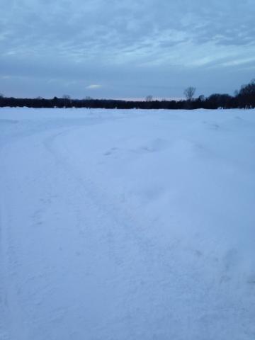

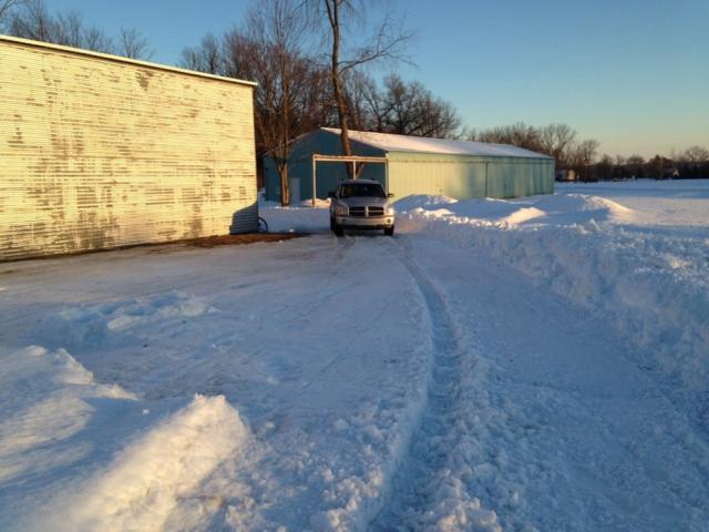

Irish Rover 14 #18 Posted February 20, 2014 Before and after photos. The knucklehead plow driver continues to p#%£ me off. Casey C-100 Share this post Link to post Share on other sites
AMC RULES 37,196 #19 Posted February 20, 2014 Yep, frozen like a rock...take your time tryin' to blow that stuff off. If you can wait till the early afternoon, might be a little easier on your equipment after it warms up a bit. Share this post Link to post Share on other sites
