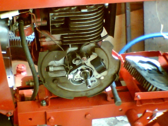

mark89 0 #1 Posted February 17, 2014 I have a tec hh60 been trying to get it to run I put new points gaped to .20 coil and condenser got weak spark enuf to light the spark tester but not to fire any ideas Share this post Link to post Share on other sites

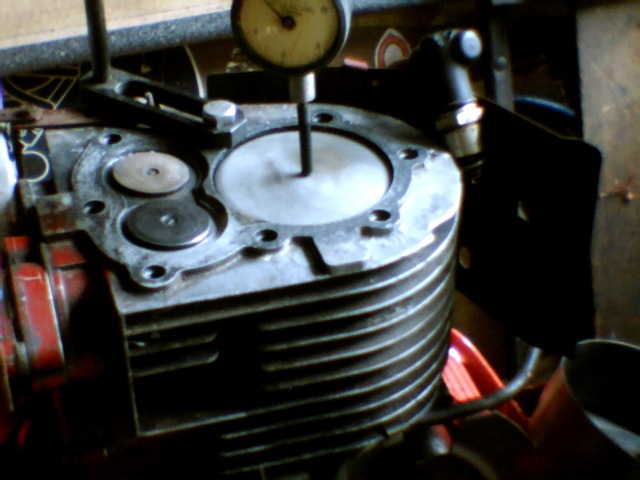

SousaKerry 503 #6 Posted March 3, 2014 Setting the gap to the flywheel is usually best guess as you have to make and adjustment put the flywheel on and check with mirror or even silly putty for clearance then take the flywheel off make an adjustment and repeat get frustrated and call it good enough. Or if your lucky enough to have the special tool for this... What is shown in the picture above is how you set the timing. The piston has to be .080"? before top dead center (measured with indicator) at this point the timing will just start to open if set correctly. Techy's are probobly the hardest engine to get the spark timed and set correctly. Share this post Link to post Share on other sites

Retired Wrencher 6,542 #12 Posted April 1, 2014 (edited) this deals with no or little spark as form this original post of H60. I did take the stator and points plate off to clean and put on new parts on as u can see buy the video. so buy marking the engine and plate do I still have to time the engine????? I thought buy making marks on the block and plate I should be ok with that. any info would be helpful. Enjoy the video. Gary B............. click on to run Edited April 1, 2014 by T1257 Share this post Link to post Share on other sites
Retired Wrencher 6,542 #13 Posted April 2, 2014 Mark- Do you have a Manual for the HH-60? I think one is on this site- You have set the spacing and rotation of the coil mounting plate in addition to setting points for correct timing. illinlet/ is the 1" to 3" dial gauge. and is the bracket home made???? Gary B... Share this post Link to post Share on other sites
mark89 0 #14 Posted April 4, 2014 Yes setting the timing is what I a! In shore of have the dial indicator just need some kind of video an or step by step on how to do it thanks for all the help you guys have given me so far Share this post Link to post Share on other sites
