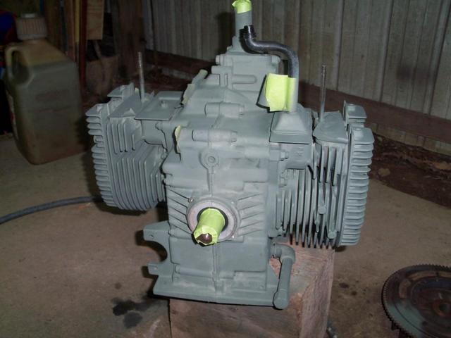

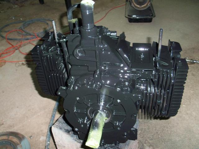

pacer 3,177 #28 Posted February 26, 2014 Re engine paint color of the KT17 - I have 2 of them on C-175s with different colors, one is what appears to flat black (or maybe sun faded black?) and the other is a grey (like I've seen on replacement engines?) The grey one seem to have the K17 front cylinder 'syndrome' , but the black one is OK. Ill be rebuilding the black one and am wondering what color? Pickle what decided your dark grey color? By the way, your nicely documented rebuild has encouraged me to tackle my rebuild, thanks... Bill 1 Share this post Link to post Share on other sites
Pickle 43 #29 Posted February 26, 2014 Re engine paint color of the KT17 - I have 2 of them on C-175s with different colors, one is what appears to flat black (or maybe sun faded black?) and the other is a grey (like I've seen on replacement engines?) The grey one seem to have the K17 front cylinder 'syndrome' , but the black one is OK. Ill be rebuilding the black one and am wondering what color? Pickle what decided your dark grey color? By the way, your nicely documented rebuild has encouraged me to tackle my rebuild, thanks... Bill pacer - I think the color is something of a low or semi gloss black. If you see a dark grey color in the pictures it is the self etching primer I use to prep before painting any bare metal, or the camera. The KT17QS 24350 overhaul was more expensive than anticipated, but hopefully it'll last the rest of my lifetime. Some parts were hard to find - the most time consuming part of the overhaul. Share this post Link to post Share on other sites
Pickle 43 #30 Posted February 26, 2014 Self etching primer versus black semi gloss paint. 2 Share this post Link to post Share on other sites

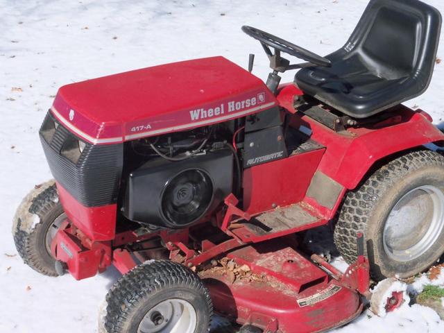

Pickle 43 #31 Posted February 26, 2014 (edited) I thought I was getting the 417A ready for the garden plowing and mowing season - picture from this mornings surprise weather! Edited February 26, 2014 by Pickle 1 Share this post Link to post Share on other sites
AMC RULES 37,225 #32 Posted February 26, 2014 Nice work Pickle... you work fast like a bunny bro. 1 Share this post Link to post Share on other sites
chazm 413 #33 Posted February 26, 2014 WELL.... How's the 417 run ? ... 1 Share this post Link to post Share on other sites
smoreau 658 #34 Posted February 27, 2014 Nice looking 85 417A!! Should last you a long time with a fresh KT17! Good Job! 1 Share this post Link to post Share on other sites
Pickle 43 #35 Posted February 27, 2014 WELL.... How's the 417 run ? ... The engine runs really well - it is a bit louder now than I recall and it doesn't hit the governer quite as often going up hills. The only thing is it seems to run at a higher rpm at full throttle. All is well. Share this post Link to post Share on other sites
Pickle 43 #36 Posted February 27, 2014 WELL.... How's the 417 run ? ... The engine runs really well - it is a bit louder now than I recall and it doesn't hit the governer quite as often going up hills. The only thing is it seems to run at a higher rpm at full throttle. All is well. Nice looking 85 417A!! Should last you a long time with a fresh KT17! Good Job! Thanks, it's realy dirty from sitting. I've considered doing a full paint & rework but it's costly and the way I use the tractor not worthy of the effort required. Share this post Link to post Share on other sites
