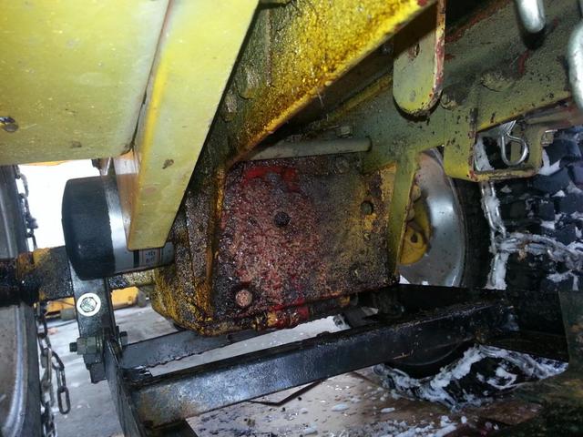

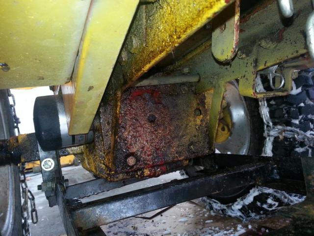

redhorserider 4 #17 Posted February 18, 2014 Heres what i see Share this post Link to post Share on other sites

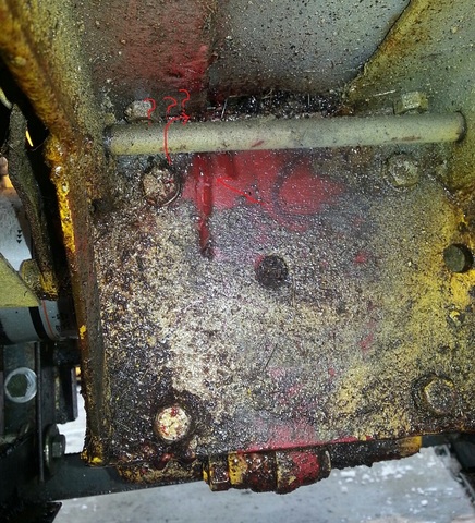

redhorserider 4 #18 Posted February 18, 2014 theres where it drips from Share this post Link to post Share on other sites

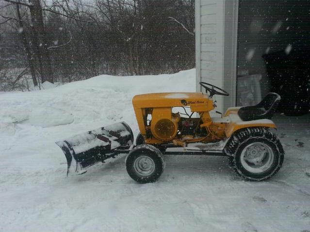

redhorserider 4 #19 Posted February 18, 2014 There she is. And no laughing cuz shes yellow Share this post Link to post Share on other sites
oldredrider 2,553 #20 Posted February 18, 2014 There are "O" rings between part numbers 51 and 52. It's common for these to begin to leak after 40 plus years. Kind of a chore to replace them but it is worth it in the end. Not sure if they are still available through Toro, but can be size matched at a good plumbing store. Share this post Link to post Share on other sites
redhorserider 4 #21 Posted February 18, 2014 Ok great. I was trying to look at the schematic to see what could be in that area but now I know what to look for. Thanks for the input Share this post Link to post Share on other sites
Digger 66 3,525 #22 Posted February 19, 2014 There she is. And no laughing cuz shes yellow I think it looks kind of cool being a BRP fan . Share this post Link to post Share on other sites
redhorserider 4 #23 Posted February 19, 2014 Thanks. I think the yellow is kinda cool too. There are "O" rings between part numbers 51 and 52. It's common for these to begin to leak after 40 plus years. Kind of a chore to replace them but it is worth it in the end. Not sure if they are still available through Toro, but can be size matched at a good plumbing store. Ok I'm not sure what these parts look like yet other than from the schematic but If I remove "51" and replace these O rings do I just put "51" right back on? Share this post Link to post Share on other sites
