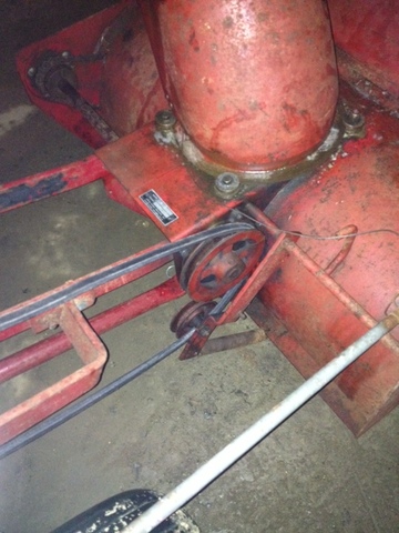

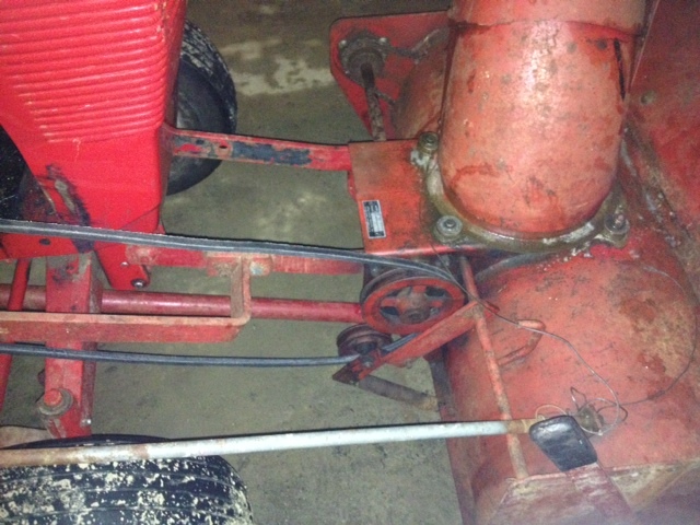

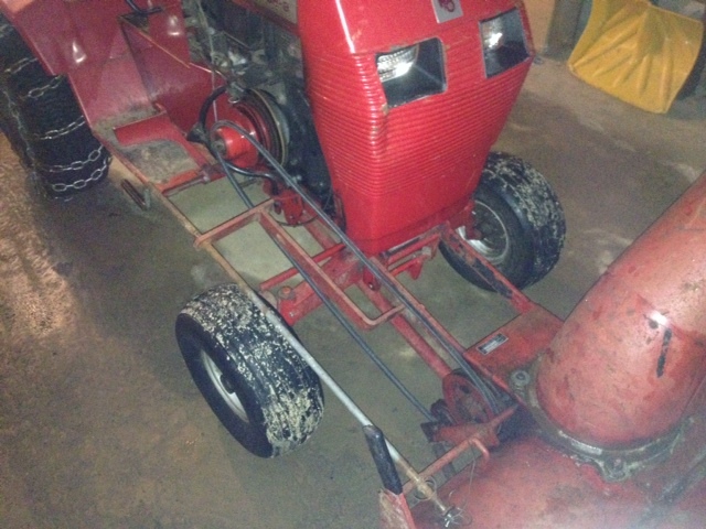

I have a 308-8 from the mid-80's and I just picked up a 6-3211 snowthrower attachment.  I can't seem to get it to work right.  I am wondering if I am missing anything or if I have the pulley running correctly.  Any help would be greatly appreciated.

That model snowblower is for the older Wheel Horse tractors -pre-1972 or so that did not have that type of attach-a-matic in front.    You may be able to attach  -should go on the frame with the front attach-a-matic removed but I have never done this before.
gwest_ca
The 6-3211 is for the Lawn Ranger models. Here is the manual
Here is one that was made for the 308-8
Garry

Thanks for the replies...so I guess I am out of luck and need to put the plow back on.  The only thing I tried that made it work was to figure-8 the belt so the auger spins correctly.
leeave96
I took an older model blower that was meant to be bolted on and cut the frame, drilled some holes at the end of the frame and inserted a piece of round bar stock through it so it would fit the front tach-a-matic. The local napa place let me try several belts until I found one that fit.
May be worth a try.
