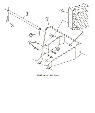

gwest_ca-(File Mod) 12,011 #3 Posted February 17, 2014 There is a rear weight frame in the Bervac snowthrower manual Garry Share this post Link to post Share on other sites

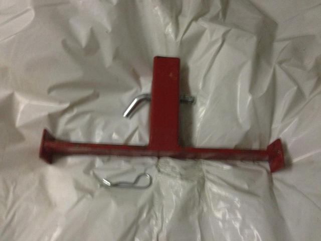

Tim 97 #5 Posted February 17, 2014 you could do something like this cut the end off a Reese trailer ball mount and butt welded a piece of flat stock with a couple of end caps to it works great also have the bervac weight frame- this is much more convenient 1 Share this post Link to post Share on other sites

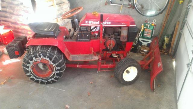

sorekiwi 761 #6 Posted February 18, 2014 This is one built to hold weights from a workout machine 1 Share this post Link to post Share on other sites

Tim 97 #8 Posted February 18, 2014 mike, did you cut up a plow frame to make yours? Share this post Link to post Share on other sites
sorekiwi 761 #9 Posted February 19, 2014 mike, did you cut up a plow frame to make yours? Yup, that was a badly repaired plow frame that I had acquired. It clips into the rear plow bracket (the wrong way around), and is held level by two straps that attach to the top straps of the plow bracket. Obviously it wont work with a plow, I use this with my blower. Share this post Link to post Share on other sites
