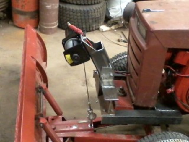

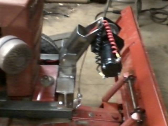

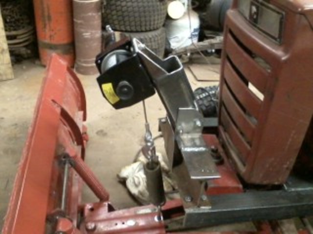

tmix 34 #1 Posted February 14, 2014 After lifting the plow 40 to 80 times the old arm was sore. This is what i came up with and the things i had to work with.Note to self keep 65# of lead in front and have it hope you guy's like it works great wish i'd done this years ago!! 3 Share this post Link to post Share on other sites

AMC RULES 37,231 #4 Posted February 14, 2014 Looks really good... last pict, bottom right...looks like you put a spring on the lifting point? Share this post Link to post Share on other sites

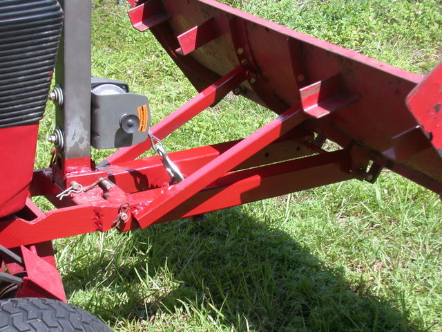

dodgemike 52 #7 Posted February 21, 2014 Very nice fab work! There is a picture of mine on the board somewhere. I just came straight out with an angle iron frame. My winch is mounted lower, but it will raise the blade till it hits the front axle. I did buy a Warn 1500lb ATV winch. Mounted the switch on the lift lever. That is what wore out after 5 years. The switch. Warn had updated with a rubber covered water proof switch. It was 79 dollars but worth it. Only other maintenance is cable but that is no big deal. I have a C121. Still could use a FEL. Dont know weather to buy used and rebuild or start from scratch. Sent from my SCH-S720C using Tapatalk 2 Share this post Link to post Share on other sites
