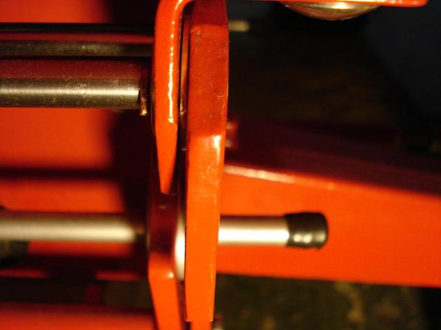

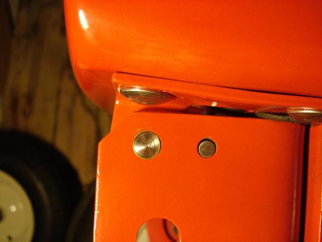

Anglo Traction 761 #4 Posted February 14, 2014 Had to check the Gallery to ensure yours is similar to my 74 layout. I also Flange Bushed my Hinges and enlarged the Hinge Pin receiver holes in the Tach a Matic. Used a section of thin wall brass tube to make bushes (3/8" id x 13/32" od) and pressed them in. Gives great ground connection for lights and just replace the bushes when worn. Although I'm in UK, the Brass tube I used is produced in US for Modellers. Should find it in Craft, Model Suppliers or Hardware Stores. (ignore the colour, it is red really) 1 Share this post Link to post Share on other sites
