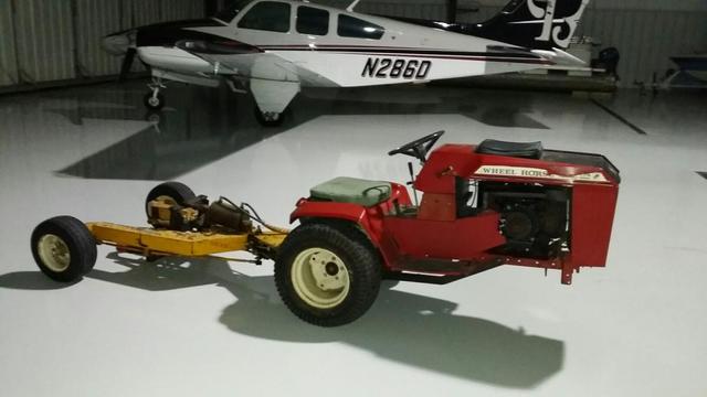

toddsanderson 23 #1 Posted February 11, 2014 (edited) Hi Guys, I am new to the forum so please excuse my ignorance in where to post. I have used the search function trying to find a re-power alternative to my Wheel Horse "Air Horse" tactor / aircraft tug. I did not find what I was looking for so I am asking for some help. This is probably the best aircraft tug available today and I want to save it instead of selling it. It has a KT-17 and hydro drive. The hydraulic pump also drives the wheel lift and steering. I have not been able to make the KT17 run properly since purchasing it. I have changed the plugs, rebuilt the carb and set it according to the manual, changed the fuel filter, etc. Basically, it will not run unless the choke is on and then it runs poorly requiring varing choke and throttle positions. I either need to have an expert go through the engine and make it right or re-power it with something modern. I need reliability as this is used to move many aircraft on a tight schedule. While I am mechanically inclined, I just don't have the time to tinker with it right now. I would greatly appreciate a recommendation of a shop that could fix what I have or re-power this machine for me. I am not afraid to spend money on it and want it correct. I would prefer to take the whole machine to a shop and have it repaired at their shop. I live in NE Indiana (Auburn) and would be willing to travel 100 miles or so. Thank you in advance for your help! Edited February 11, 2014 by toddsanderson 3 3 Share this post Link to post Share on other sites

toddsanderson 23 #4 Posted February 11, 2014 I replaced the plugs, rebuilt the carb with a new float, needle, as well as new gaskets. I could not get the main jet out without destroying the carb, so I made sure it was clean and re-installed everything. Same problem. I then bought another brand new carb with an electric choke (otherwise the same carb - used in generators). I disabled the choke and used it manually. Same results. It would appear that I have a lean condition with possibly a weak fuel pump, but I can see fuel flow through the filter when it cranks and runs. I'm wondering if I possibly just have a worn out engine, bad coil, or possibly points bad. I really would like to stick a Honda or Briggs engine in it, but cannot find anyone that has a kit available. I'm sure a shop could handle fixing the one I have or re-power, just can't seem to find one. It really is a neat machine and moves airplanes well. If I can get it to run correctly I plan to restore it to like new appearance. Share this post Link to post Share on other sites

toddsanderson 23 #17 Posted February 19, 2014 Well, some good news! The fuel shutoff valve was seized in place. I twisted it back and forth a few times and it broke loose. When I cranked the engine over I noticed the fuel flow through the fuel filter was constant and had much more volume than before. The engine fired right up and ran like it should whether at idle or full speed. Regardless, I am going to have Scott's dad go though this machine completely. It has oil leaks, the fuel lines are old, the plug wires look old, and it needs a brand new paint job and body work. It should be neat to see what it looks like done. 6 Share this post Link to post Share on other sites
toddsanderson 23 #18 Posted March 11, 2014 Well, it looks like my horse will get a new Briggs vanguard twin. Mine has carb issues and probably could use points etc. I need this machine to be reliable to move the planes. Should be really nice with modern power. The old KT17 is low time and is mechanically fine. Anyone here have use for the engine? I had an offer a few months ago when I first thought of repowering. Would be happy to sell it to someone on the forum first. Share this post Link to post Share on other sites

toddsanderson 23 #20 Posted April 14, 2014 Air Horse is just about done. New Briggs being final fitted and tin is at the powdercoaters. Looking forward to having it back. It sure makes moving planes much easier! Share this post Link to post Share on other sites
