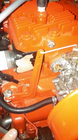

zanepetty 117 #9 Posted February 11, 2014 Here are some pics Share this post Link to post Share on other sites

zanepetty 117 #14 Posted February 11, 2014 Here's a top view. The inner cable hits that little screw. I don't think that's my over reving problem though Share this post Link to post Share on other sites
zanepetty 117 #15 Posted February 11, 2014 (edited) Just ignore that last post about the cable and screw. I got that part. Just the setting problem is all I gotta worry about and it is pushing against my finger right now.. is there anything that could make it not work sometimes? When I do the test Bob told me to do, half throttle n high gear up a grade, the engine bogs and on level ground it over revs. Yet the arm will push back against me. Edited February 11, 2014 by zanepetty Share this post Link to post Share on other sites

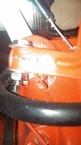

boovuc 1,090 #16 Posted February 15, 2014 (edited) Haven't heard from you on this issue Zane. How did you make out. I wanted to state before to make sure that your governor swing arm isn't binding up anywhere making it do intermittent stuff as you described in one of your later posts. Let us know. On the one picture of the swing arm, it looks like it could be rubbing. Edited February 15, 2014 by boovuc Share this post Link to post Share on other sites

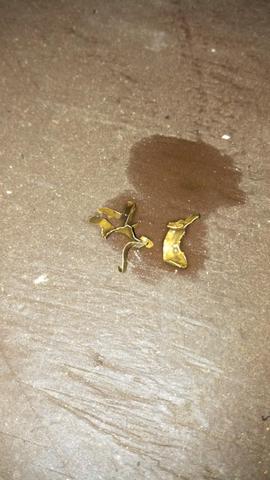

zanepetty 117 #17 Posted February 15, 2014 Here's what I found when I took my oil pan off. I have no idea what I is. Haven't gotten a chance to take the rest of the stuff out of my engine yet. I really appreciate you checking up on me. I'll be rebuilding my engine while its a part. Where can I get a new governor assembly? Share this post Link to post Share on other sites
rmaynard 16,588 #18 Posted February 15, 2014 Best place to get governor parts is eBay, or one of our vendors. The outside parts rarely go bad. The only thing I can think of is this spring could break or somehow get bent. Some of the internal parts can be purchased new or used. The gear is still available. The cross-shaft can also be found on eBay etc. The only problem I have seen with them is the rivet comes loose or breaks. But if you can only rotate it about 1/8th of a turn now, it's probably okay. I have seen gear teeth break, and I have seen the center hole of the gear get worn, but I have not seen a fly-weight break or come off. Considering the age of the engine, it probably has a cast iron gear which holds up better than the plastic ones. What worries me the most is what you found in the pan. I have been looking at the picture since you sent it to me, and I cannot recall anything inside the block that is made from soft, easily bendable sheet metal. Share this post Link to post Share on other sites
boovuc 1,090 #19 Posted February 15, 2014 Not a clue what you found in the pan. It looks mangled though! Thank God for gravity! Share this post Link to post Share on other sites
rmaynard 16,588 #20 Posted February 15, 2014 Zane - take another picture of it and put a coin or something with it so we can get a size perspective. What kind if metal is it? Looks like brass. Share this post Link to post Share on other sites
chazm 413 #21 Posted February 15, 2014 Looks like a brass shim to me, possible cam shim ?? Share this post Link to post Share on other sites
zanepetty 117 #22 Posted February 16, 2014 Could be a can shim. I have been so busy with valentines day lately I haven't had time to take a picture. I will tomorrow though. I don't have any good machine shops around that I know of. I want to make sure everything is in spec. And I want to check out bearings. I'd almost like to just find a shop and just ship it to them at this point. Share this post Link to post Share on other sites
buckrancher 2,695 #23 Posted February 16, 2014 cam shims are made from steel looks to be something a past owner added or changed for some reason as there are no brass pieces inside of a kohler k161 from the factory that I know of Share this post Link to post Share on other sites
zanepetty 117 #24 Posted February 16, 2014 Oh. Thats always GREAT to hear, Brian. Good old home made jerry rigging. Oh well. I plan on try to tear all of it down tomorrow. I'll post some pics and what not. Hopefully I can find someone to build it or at least help me build it. Share this post Link to post Share on other sites
